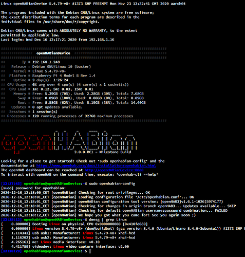

Just burned 64bit OpenHabian to an SD card, planning to immediately migrate to OH3 through openhabian-config. But on step one after powering up the pi:
[10:08:53] openhabian@openHABianDevice:~$ sudo openhabian-config
[sudo] password for openhabian:
openhabian is not in the sudoers file.  This incident will be reported.
[10:09:10] openhabian@openHABianDevice:~$

I can confirm this error, it happened to me the exact same way.
By the way, I use an RPi 4/8Gb.

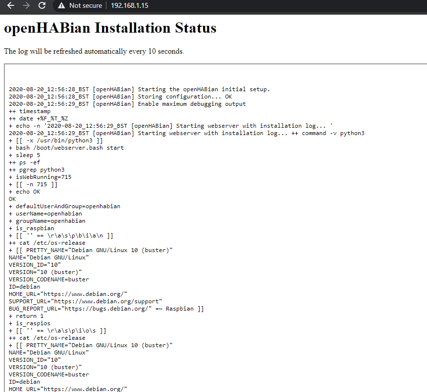

If you want to contribute better do debugmode=maximum and install to get a log that shows where the renaming does not work.
OK - Note I did this and added it to the GitHub issue
firstboot.log (288.9 KB)
If you need anything else I can start all over again until me SD card dies.
Oh and this is AWESOME
In firstboot.log with debugmode=maximum I see
2020-12-27_22:53:47_GMT [openHABian] Changing default username and password... + [[ -v openhabian ]]
+ id openhabian
+ echo SKIPPED
SKIPPED

So it fails in /boot/first-boot.bash line 62 or right after.
You can also edit /boot/first-boot.bash to insert some debug output such as the values of the variables that are tested against in that line
Edit, remove /opt/openHABian-install* and reboot to trigger a reinstall.
