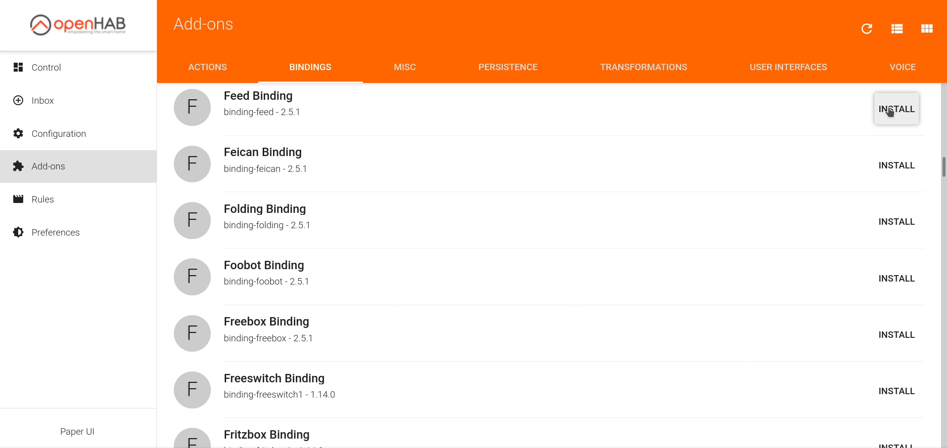

  2. Install the Feed binding…

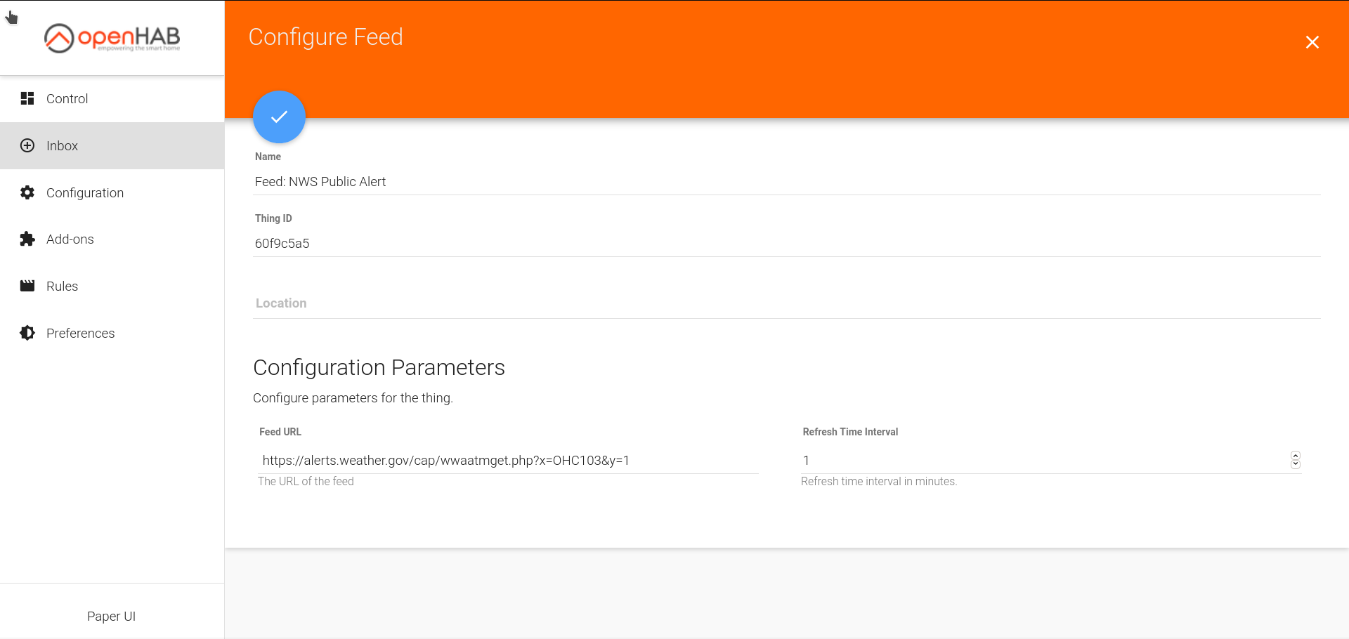

  3. Create a Feed Thing and use the URL from step 2…

Should there be an example here?
Sure… I’ll put in a screenshot and link to the Feed binding docs.
Sorry, I did not realize there is a feed binding. I assumed something using http.
No worries… I added that step too!
