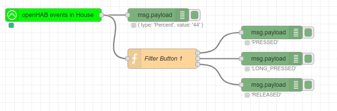

These are the solutions I have running.
The IF statement is this
var event = msg.payload.event;
var channel = msg.payload.channel;
var newMsg = { payload: msg.payload.event };
var button = "velbus:vmbgp2:c5053467:24:input#CH1"
if  (channel === button )  {
	if (event === "PRESSED") {
		return [newMsg, null, null];
	if (event === "LONG_PRESSED") {
		return [null, newMsg, null];
	if (event === "RELEASED") {
		return [null, null, newMsg];
return null;
With the nodes being configured like this

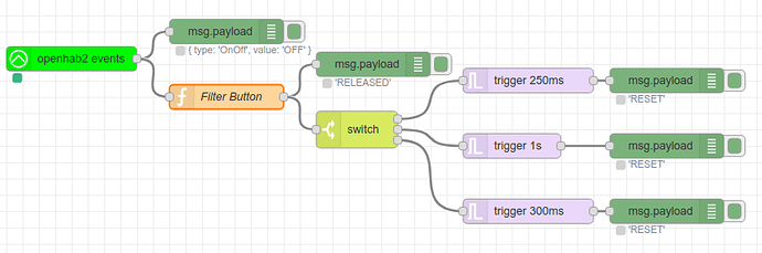

The version with the IF Function to filter the button and a Switch to filter the button states, then with some triggers to reset the Debugs so that new events can be seen in the Flow, looks like this
The IF Function is simply this
var button = "velbus:vmbgp2:c5053467:24:input#CH1";
if (channel === button) {
    return [newMsg];
return null;
With the Nodes configured like this
