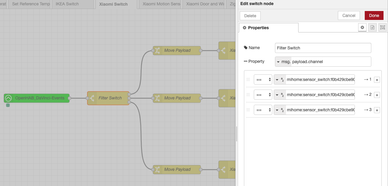

Hi there!
I use a simple switch node for filtering the events I want from the Openhab2 events node…
Like this…
This way I didn’t have to create a complex function node.
In the image I’m using the same switch node to extract data from 3 different Xiaomi wall switches.

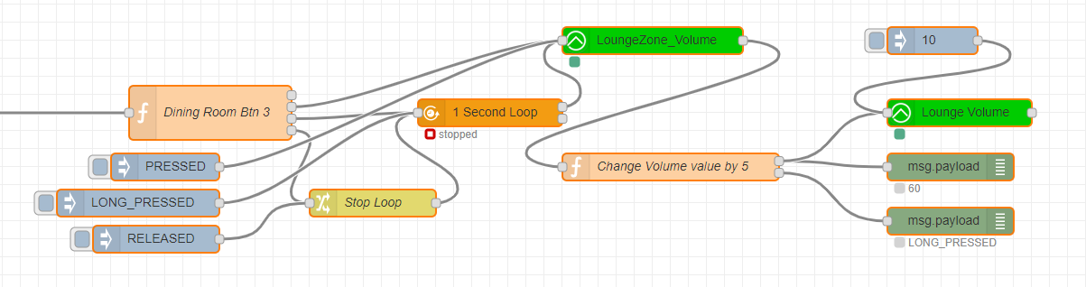

Hi All
A happy new year to everyone :slight_smile:
Something has been bugging me for a while, so I have spent an hour finding a solution.
What I wanted to do was mimic the Press and Hold dimming / volume change that you might see in some hardware.
I found a way to detect a button event, get the current Item state (a number) and add or subtract a number then inject the new value back into the Volume or Dimmer Item.
This worked well, I had 2 buttons.
1 for up
1 for down
I could even use the Long_Press and Release states from these buttons to loop the trigger so that holding the button down kept on having an effect, until the button was released.
What I wanted to do was reduce this down to 1 button, that would increase the volume (or brightness) until a limit was hit, then decrease until another limit was hit.
I found the solution by using a Global Value in Node Red.
Here is what I have running now in a Function node :smile_cat:

Here is the entire collection of Nodes

The amusing thing (or at least to my mind) is that if I hold the button in the Long_Press state, the volume (or brightness) will happily glide between 5 & 95.
Not a feature I can see using very often, but a nice side effect.
I hope this helps someone.

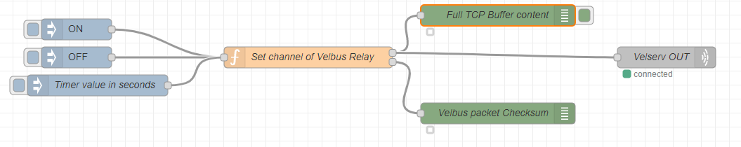

Hi
I’ve managed to code my first bit of Javascript in a Function node.
It’s not pretty, but it’s working :smile:
If you have a Velbus setup, you might be interested to take a look

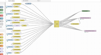

Hi All .From a Still LOCKED DOWN South Africa.
i have a question. not sure if this is the right place to ask. i use node red for my Alarm monitoring. but i have a slight problem i cant wrap my head around.
  1. when i havesay a Burglary condition. and the alarm goues in to reset time. (still armed away) my rule sets the alarm status back to disarmed. but it is still armed. how do i have node red look if my alarms armed input on my raspberry pi is still armed and send the armed msg. instead of the disarmed.
here is my flows.
