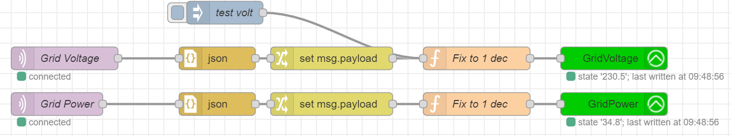

Hope someone can lead me in the right direction, I have openhabian 3.1.0 and node-red also updated today.. I am using the updated OpenHab Palet in Nodered.
My issue is that an item gets updated from MQTT, then I do some work on it in Nodered and need to push it to OpenHab. The item does get reflected fine in OpenHab with new values, but nothing goes to the IOS App. The item is displayed but the value is blank.

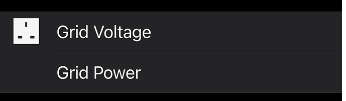

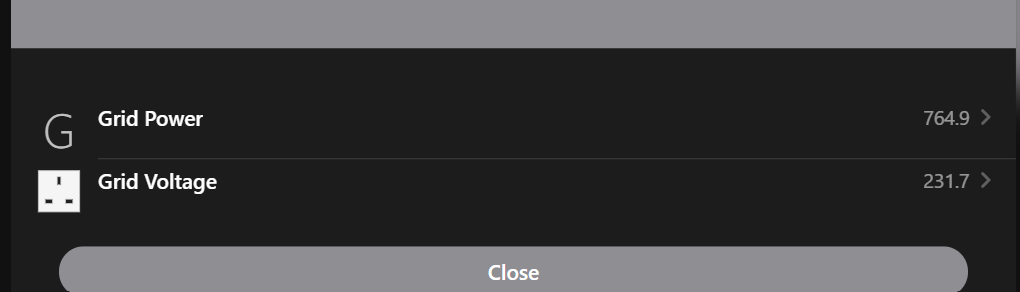

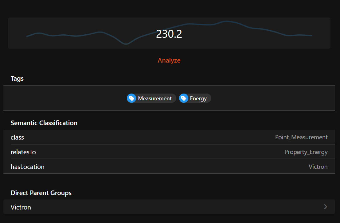

Web App:
IOS App:
So you’ve shown it’s nothing to do with node red, the mystery ‘web UI’ shows the value you expect.
Assuming that is MainUI, it doesn’t use your sitemap, so the next area of interest for IOS app is your sitemap entries.

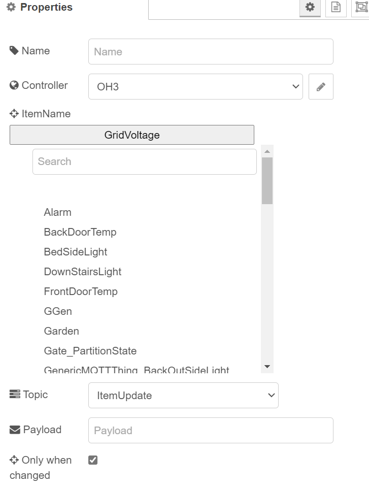

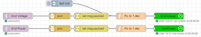

Yes that is in the main UI, which tells me that the data is coming in fine from Node red. Below is the entries from node red and my sitemap.
and here is the config of the opehab node:

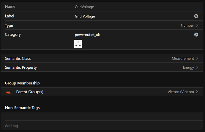

And here is the item and sitemap:
Sorry for the lost of pics, but hopefully this helps you. let me know if there is anything else you require?

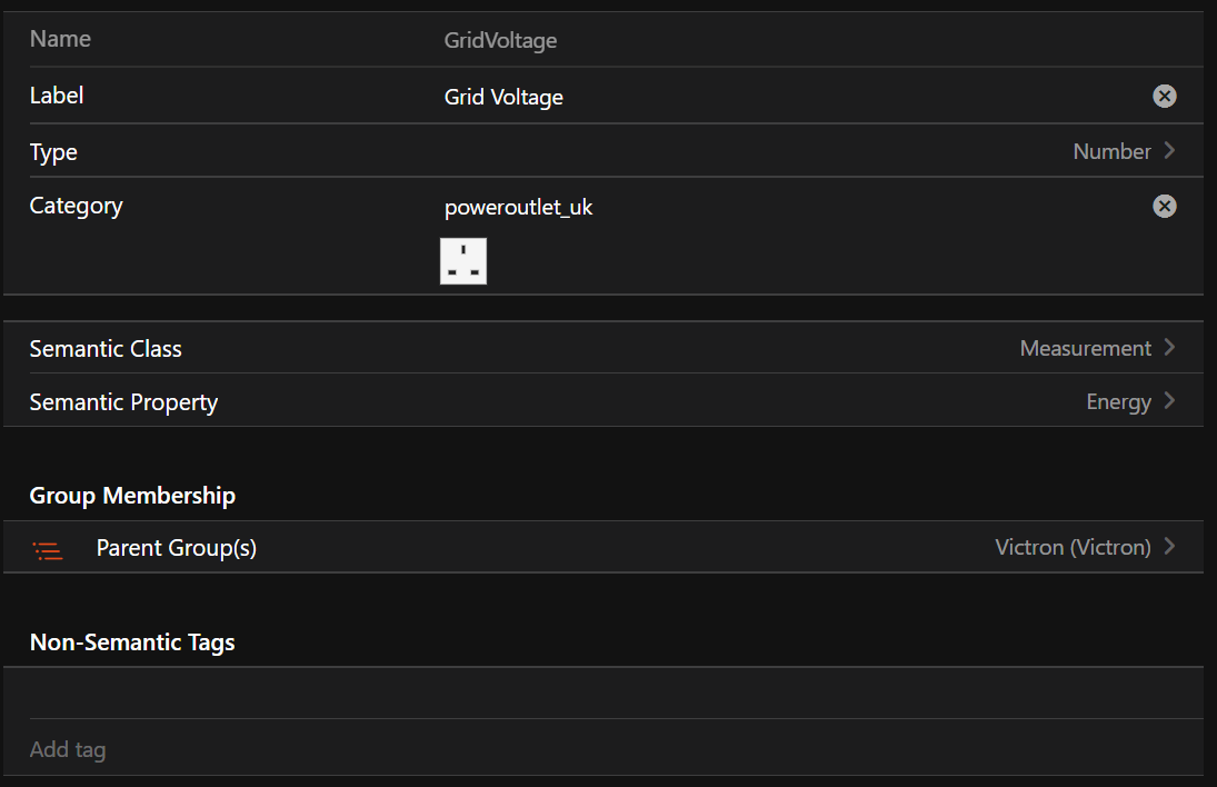

The Item you are looking at is GridVoltage, it’s a Number type, it has state “230.2” - so far so good.
This Item does not appear on your sitemap at all.
That’s okay, it appears to be a member of Group Victron and that does appear.
So we’d expect to view GridVoltage when the Group is viewed, and sure enough we do. But the state is not visible in IOS viewer.
