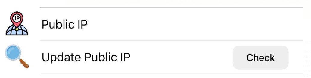

Now the problem is that my iOS App doesn’t show the value.
I know the value is correct by checking the logs from the rule and also on every other device the sitemap shows the value correctly.
For example- BasicUI on my PC, checking the value in MainUI, and the android app on another mobile device.
Unless it’s a problem of the iOS App, I think that the problem is connected to the type the currentIP var get. (That’s why I decided to put it in this section of the forum)
If I simply write something like this, the iOS App shows the value like expected:
Sys_PublicIP.sendCommand("192.168.0.145")
It’s obviously not the correct IP, just put a random string value but of the same “structure”. But any proper string works.
My guess is that I should cast the result of the executeCommandLine somehow but I can’t figure out the proper way. But then again I might be totally wrong ![]()
