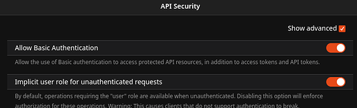

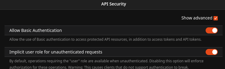

And to also clarify I have the following set on my API Security page, unsure if this is need for NR or the purpose is for something else?
Actually I don’t know if it is really necessary to set the second one, first one is not required.
Mine (default) settings are

In OH3 Administration > Settings > System Services > API Security
Verify that Allow Basic Authentication is turned on
Admin (In bottom left) > Create new API token > Create API Token
Create your token, make sure to copy it down before you leave the page
