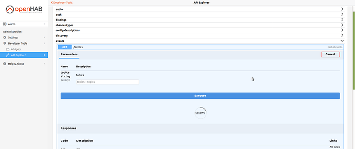

I just saw that Node-Red makes a request to the events. But it fails.
So I made a check with the API Explorer. But also there the GET command is not executed. See in printscreen:
Do you also have the same problem? I am running Build 1996
