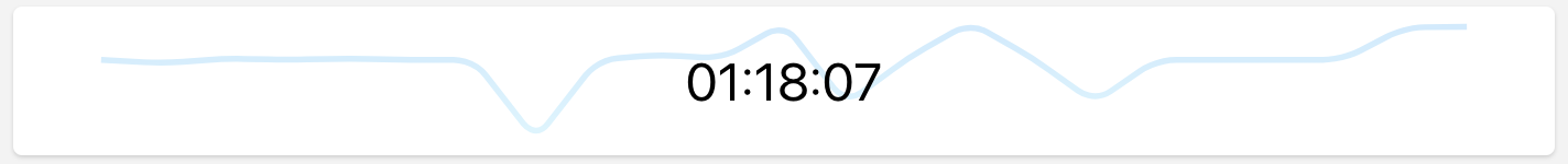

Use DateTime formatting strings. For example the runtime of my UPS is formatted as %1$tH:%1$tM:%1$tS which is currently showing

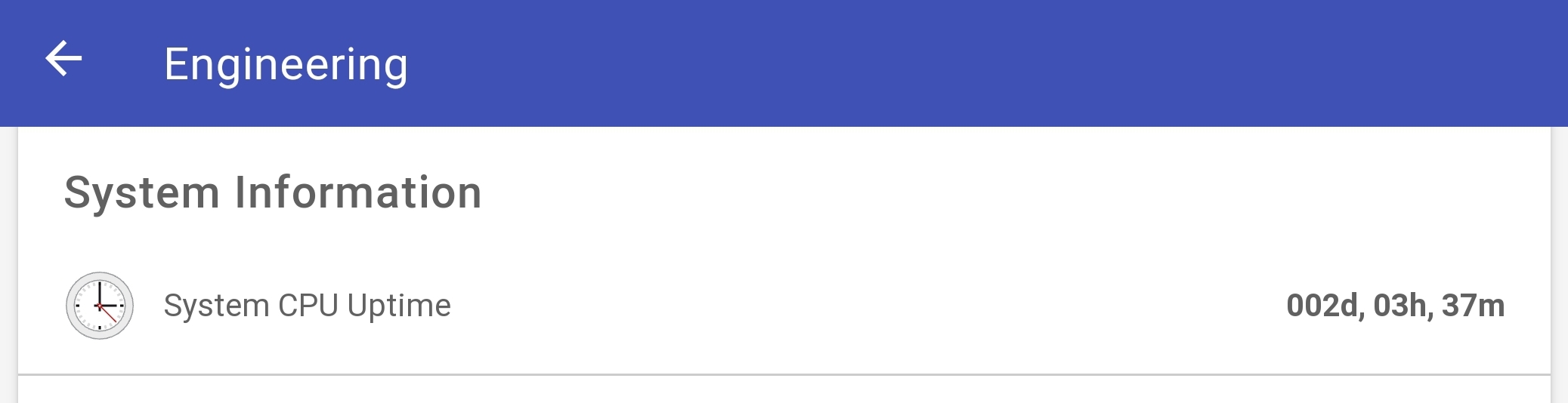

Just to report back: It seems that %1$tH does wrap at 24hours, and nominally %1%tj seems to work(ish) but oddly it was showing 0 days yesterday, and it shows 2 days today (see below). I’m not sure if this is a problem in the raw data from the System binding (or from my CPU clock), or if it is a problem in the format string. I will explore further, and report back again.
The raw value returned from the System binding is 1673 minutes which is a little over 27 hours. So evidently the format string is wrong to show 2 days and 3 hours. Is this a bug, or am I missing something?
Remember that you are (ab)using date-time formats. $tj is ‘day of year’, isn’t it? First day of year is 1, so <24hrs is day one. These are not duration or elapsed time formats. Clock hours and minutes begin at 00, but dates begin at 1.
So why was it showing day 0 yesterday (less than 24 hours elapsed) and day 2 today (27 hours elapsed)?
Set your root value back to what it was, and find out. This just isn’t going to do what you want.
