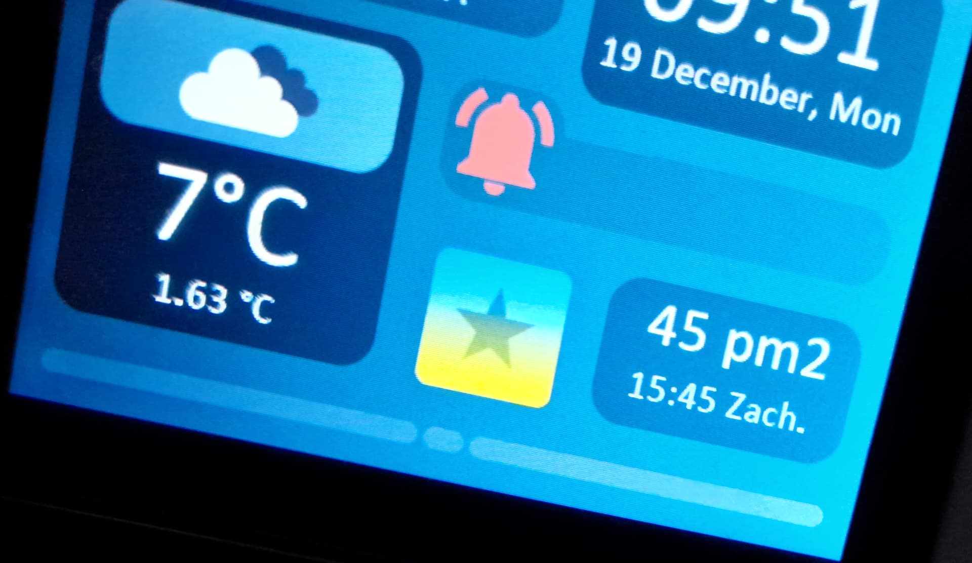

guys what is wrong with my payload:
Item 'nxpanel_weather_command' received command { "weather": { "temp": -7.6, "icon": "04d", "summary": "1.63 °C" } }
that I do not get minus before 7 degree?
Update: Fixed myself. “” for value were missing :slight_smile:
