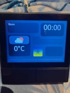

by the way. the first picture i can see is..

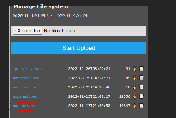

Have you actually installed 1.1.4 of the berry script?
You need to copy this to your device using;
Make sure that is the 1.1.4 version.
yes i am using nxpanel.be from peepshow-21-
I thought Berry 1.1.4 was a driver that i had to install extra. Didn’t think this file was meant.

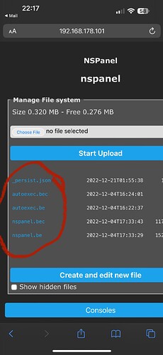

After reboot and delete *.bec files
What does the error mean:
21:25:12.765 TFS: File ‘autoexec.bat’ not found
This error comes up with every reboot.
Other Tasmota versions has other errors.
But it is too much text to send it here.
00:00:00.002-209/49 HDW: ESP32-D0WD-V3
00:00:00.108-207/49 UFS: FlashFS mounted with 288 kB free

Emmm, sorry for my stupid question? But do you have the autoexec.bec there? As it needs to be, but the log shows that the file is not found…
good morning, of course I have these files. I’ve re-created them a number of times. a few times Tasmota reflashed with esptools and sometimes also via OTA. made no difference. After flashing, no files were entered and since these *.bec were generated, I hoped for normality. When I switched to NXpanel I had Tasmota 12.3.0 on it via web installer and NSPanel worked. I followed the instructions here to create the NXPanel.be file and the progress bar also went up to 100%. after the reboot I noticed that the time is not displayed like on the success messages from others. Since then I have been re-flashing real versions of tasmota. Unfortunately, I can’t determine whether it’s due to Tasmota or the NPanel module.
I couldn’t find out whether there is a way to re-enforce the installation process as if NSPanel was still on it. whether there were problems with tasmota 12.3.0 and the install or I was just unlucky, who knows? as long as I don’t manage to force a new installation of NXpanel, I can’t change anything about the status. maybe a detour via an installation of ESPhome will help? I’m open to all ways to use NXPanel. I won’t give up…
and it wasn’t a stupid question, unfortunately I had also dealt with it
thats after reboot on Tasmota 12.3.1 an delete the *.bec files.
The *.bec were rebuilt . and the problems remain

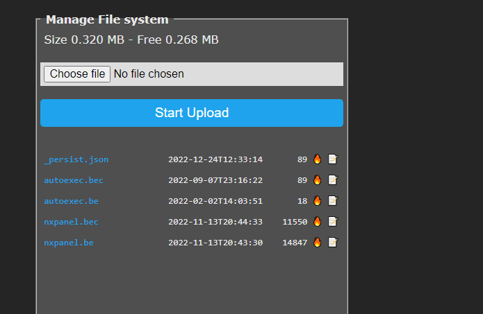

Guys, I’m further along than I ever thought I was. While searching the net, I found a piece of information that solved my problem. That’s how I believe it, because installnxpanel triggers another installation of the NXpanel. I had to enter the building rate to 9600 in the nxpanel.be. Blunt copying of nxpanel.be doesn’t work for everyone. Why some can cope with 9600 and others 115200, I do not know. But it didn’t matter which Tasmota version I had taken.
After I nxpanel.be on 9600 I had no error message in the console after rebuilding nxpanel.bec. After I ran InstallNXpanel and the installation bar appeared again in the display, a stone fell from my heart. 4 nights hardly any sleep and felt the entire internet read through… Merry Christmas
I’m a bit lost why you are talking about 9600/115200 stuff for nxpanel.be??
This is copied to the device over the wifi via the filemanger in the tasmota web gui??
There’s no serial in this?
Or are you talking about when the nxpanel.be script install the HMI file into the Nextion?
I updated my TAS to 12.3.1, just as you, my nxpanel.be is 1.1.4, as above.
run xnpanelinstall for tas and it works a treat…

Hi Mike, thanks for your help. In the meantime I had wanted to set up a second NSPanel after the instructions and setup with nxpanel.be and got the same result. It was written by Installnxpanel with 115200 builds and went up to 100%. After the reboot, the time was also displayed there. I could not force reinstall both panels. Only when I read about the solution in a post to simply change the build rate from 115200 to 9600.
at the bottom right when booting is now the Berry and Panel version, which was missing until now. The panel boots without me having to press OK buttton. with 12.2.0 still no clock time was displayed. after upgrading to 12.3.1 and the build rate of 9600, both NSPanels now work.
Why Installnxpanel could install with 115200 on the first attempt and not afterwards, I do not understand. now I can’t explain that I had to change the value to 9600 in nxpanel.be to get a working panel. now I also see the desired messages in the console when pressing switches and buttons. That with two panels the same problems and solutions are, strangely, Thank you and mary Christmas
P.S.
Here I found the reference to the solution with the baud rate to 9600
Otherwise I always got the error after trying to use installnxpanel again:
[BUG] Something has gone wrong flashing display firmware
Now it works with this weird change
Thats now my nxpanel.be.
