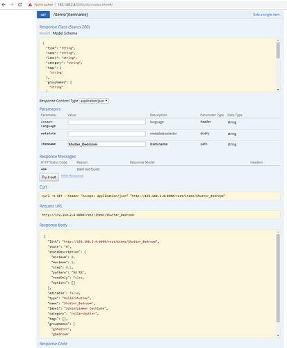

Just found out how easy that is by installing the Rest Documentation from the “Misc” section of the Add-Ons and then accessing it through the dashboard:

You mean the chart here?
ALL Rollershutter Items have the same properties. One of the main purposes of Items is to model your home automation independent of the devices and technologies in use. A Homatic Rollershutter Item is identical to a Zwave Rollershutter Item.
