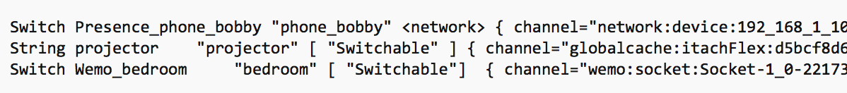

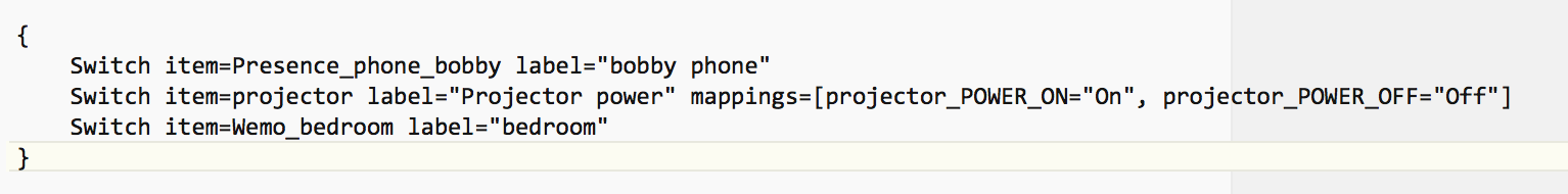

is it possible to turn a string into a switch in some way? so i can control my projector by voice?
see below , i have a couple of simple items working in openhab and now i’m able to use google home to switch the wemo on and off.
After reading into on here I understand that i can’t make the string switchable. So i was wondering if there is a way round this. maybe i could make a rule or something that would reference the string and turn it into a voice controllable switch? Can anyone point me in the right direction or direct me to a thread that might help?

Create a Switch Item with the switchable tag. Create a Rule that triggers when the Switch Item receives a command. In the Rule send the appropriate String to the Projector Item.

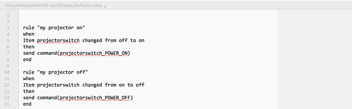

Hi Rich, thanks for your response,
first off, is this the correct place for me to be asking these type of questions or should i be posting elsewhere?
i’ve been reading posts and guides all day about this but i’m not really getting it. i think i’m missing a few major steps.
can you recommend anywhere else i can learn about rules other than https://docs.openhab.org/configuration/rules-dsl.html
I’ll keep reading in the meantime.

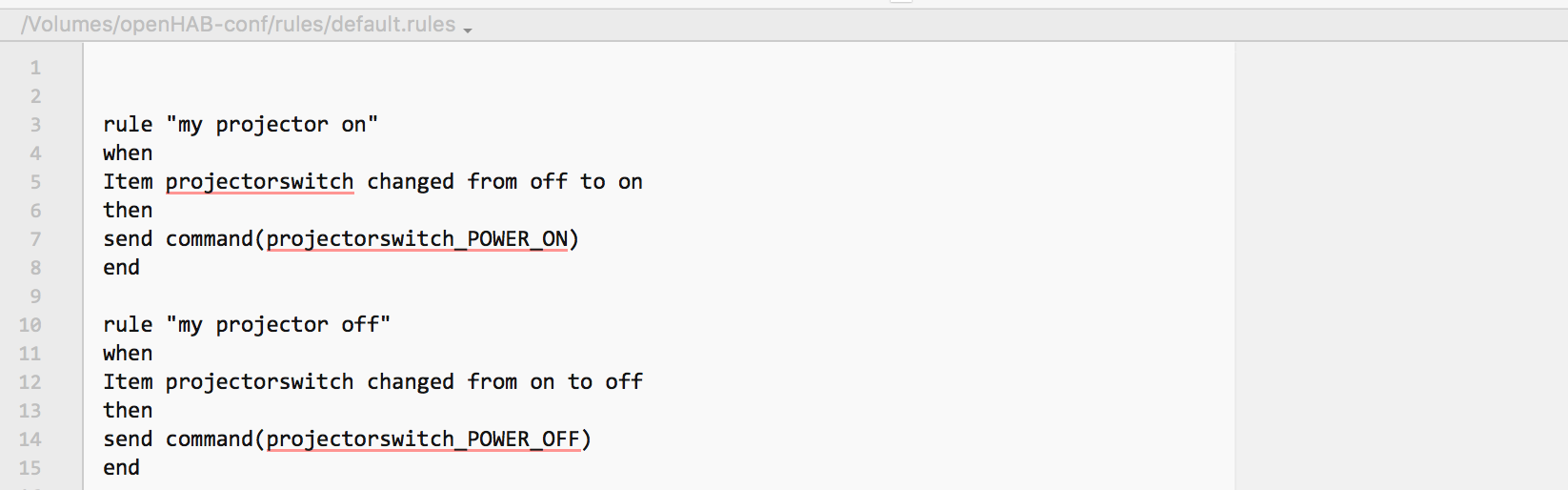

default.sitemap
default.rules

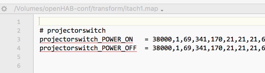

my map file
default.items
i feel like the channel is not needed here wrong for this because i want it to work from the rule? how does openhab know to use a rule i created, do i need to add a line to the item or sitemap to point to the rule?
i was getting this in the log earlier but now im not so does that mean my syntax is now correct
anything else you can advise or reading material you can recommend is much appreciated.
thanks
bob

  1. I would use the default upper case ON and OFF instead of on and off or even powerswitch_POWER_**.
  2. Why do you map the values two times?
    On = projectorswitch_POWER_ON = 38000,0,…
  3. If you need the same mapping for multiple items use the map file. Otherwise I would just put it in the item definition.
  4. It is sendCommand(projectorswitch, ON) not send command(projectorswitch_POWER_ON)
There might be more errors in your config, but this is what caught my eye. :wink:
It is probably better to post a new thread for questions like these.
Then copy and paste the code into your post. Many of us use our phones and screenshots after impossible to read. It is also much easier to copy your coffee and fix what is wrong instead of making us retype everything.
Use code fences: How to use code fences
The rules page is the documentation for the rules but based on the errors Christoph identified I think what you need to do is pay really close attention to the docs and examples. Everything matters including spaces and case. Use VSCode to help identify does as you type.
Install the demo package and look at those rules. Make small changes to set how it changes things.
I also recommend reading the beginner’s tutorial and the concepts section of the users guide because you lack an understanding of how the pieces of OH work together. For example, devices are represented as Things. Each part of the device is represented by a Channel. Items link to Channels. Rules work with Items. If your Item is not linked to a Channel your Item can’t talk to the device.
That is what the Item projectorswitch changed from OFF to ON means. That tells OH to run the role when that event occurs in that item.
