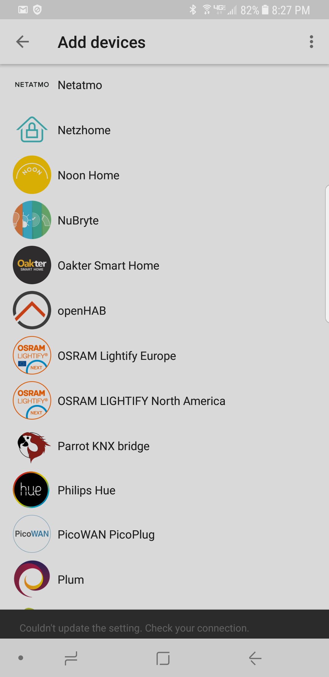

I am getting an error though… After linking works, I hit done back to the Home app and at the bottom I get the message “Something went wrong. Try again.” (That’s on IOS)
From an Android tablet, I get the “Linking your OpenHAB account”, then “Couldn’t update the setting. Check your connection”
Any ideas?
I’m getting this error after allowing oath
“couldn’t update the setting check your connection”

@waspie, @Ian_Bishop @cporourke - I did stumble across a vague report of issues with syncing devices for people who had multiple users set up on the Google Assistant - just a shot in the dark here, but maybe that’s the issue?
I just saw that as well. I had three different users on my phone so I deleted two of them…no luck yet but I haven’t turned anything off and back on yet. I’ll report if I get any movement.
I only have one linked account for google home/assistant.
