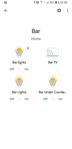

You can drill down into rooms, in this case I pressed on Bar. I see I need to come up with better names.
