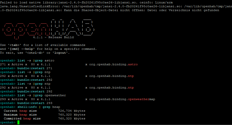

  • The Astro binding stopped working, so my rule couldn’t switch on the light when daylight finished. No information was found in the OH log even with debug level. Restarting the binding did help with the first try!
  • The NTP binding did not update the actual date. Here the restart did not help.
  • OpenWeathermap binding unexpectedly stopped updating the linked items. Again no entries in the logs. After restarting the binding, the thing kept in status INITIALIZING.
  • The notifications that should be sent by the Exec binding to a Gotify server, did not come up in the Gotify clients. I couldn’t find anything in the OH log even with debug level.
This was the overview from openhab-cli console showing a rather heavy usage of memory:
Here is the console output including the above steps and the java heap size:

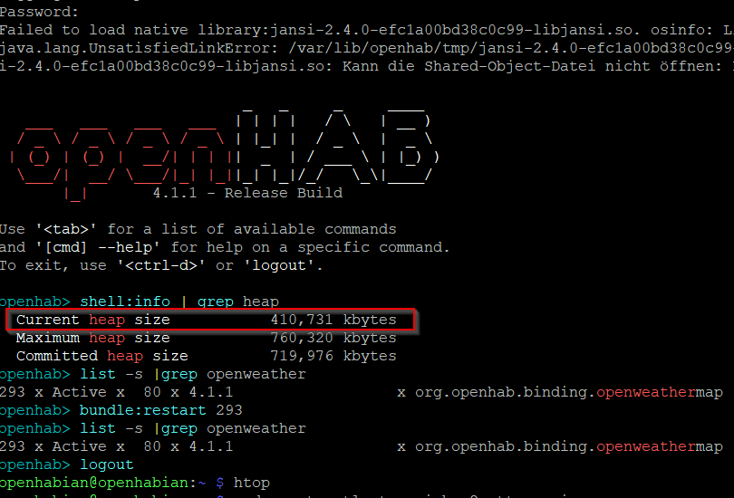

After restart of the openHAB service, the Java heap size is quite normal:
grafik

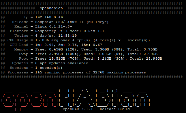

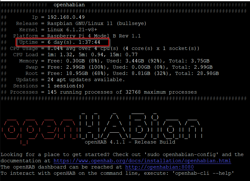

Right now after OH 4.1.1 running for 6 days I have the situation, that the UI, frontail and Zigbee2mqtt are not responding.
Stopping the bindings astro, ntp, exec, openweathermap and several others does not solve the situation. Only restart of OH helps. This time I run reboot.
The next time it stops, run top or htop (if available) to see your overall RAM situation. If stuff outside of OH is failing to run that points to an overall system problem (maybe you are out of RAM?).
