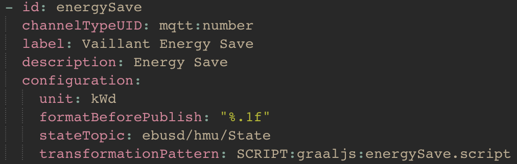

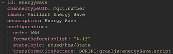

Depending on the thing type, but from main UI, you should have a code tab for your thing. Just change code from JS:filename.js to SCRIPT:graaljs:filename.script, meaning you also need to copy/change your .js file to .script file within your openhab-conf/transform folder.
Example for MQTT thing/channel below:
