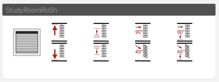

I am looking for a solution for this roller shutter widget (visually still draft):
I have defined some custom icons. The widget is functional, the icons create commands, there is a Jython rule handling the movement, everything works as expected.
I would like to get some sort of “button feeling” when clicking, at least having a tooltip. Unfortunately, oh-icon does not support tooltips.
Any idea would be appreciated.
