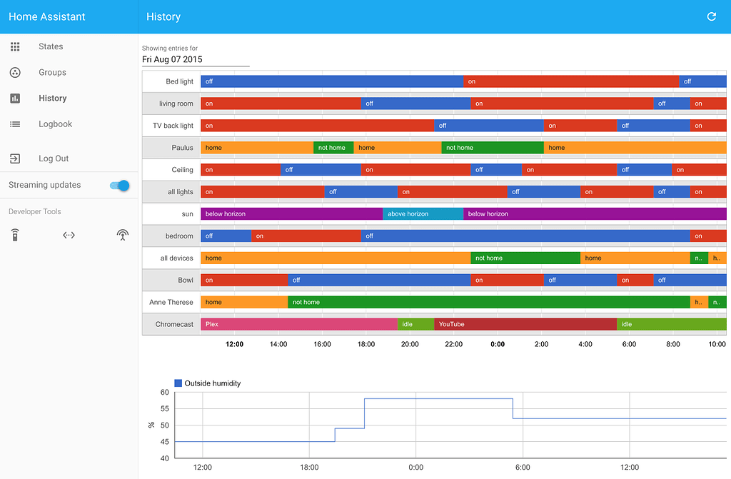

I’ve seen a few posts requesting a way to show multiple switch items in a timeline similar to HA.

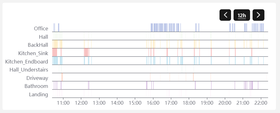

I’ve managed to hack together something that might be of interest to people. And maybe someone is clever enough to help me make this work with a repeater somehow to make it easier to populate and add/remove items, and resize things gracefully. It’s a bit janky to change the number of items and resize things in this current form.
You will need to adjust the naming scheme to match your items.
I’m also seeing a bug where the chart will look off-center and can’t zoom when first loaded. When I change the time range it loads properly and I can zoom again.
There seems to be lots of properties that don’t accept expressions. This is quite annoying and is maybe a bug that can be fixed. It would be useful to be able to use an expression in the height property so that the entire chart could be resized without having to edit every instance each time for example.
