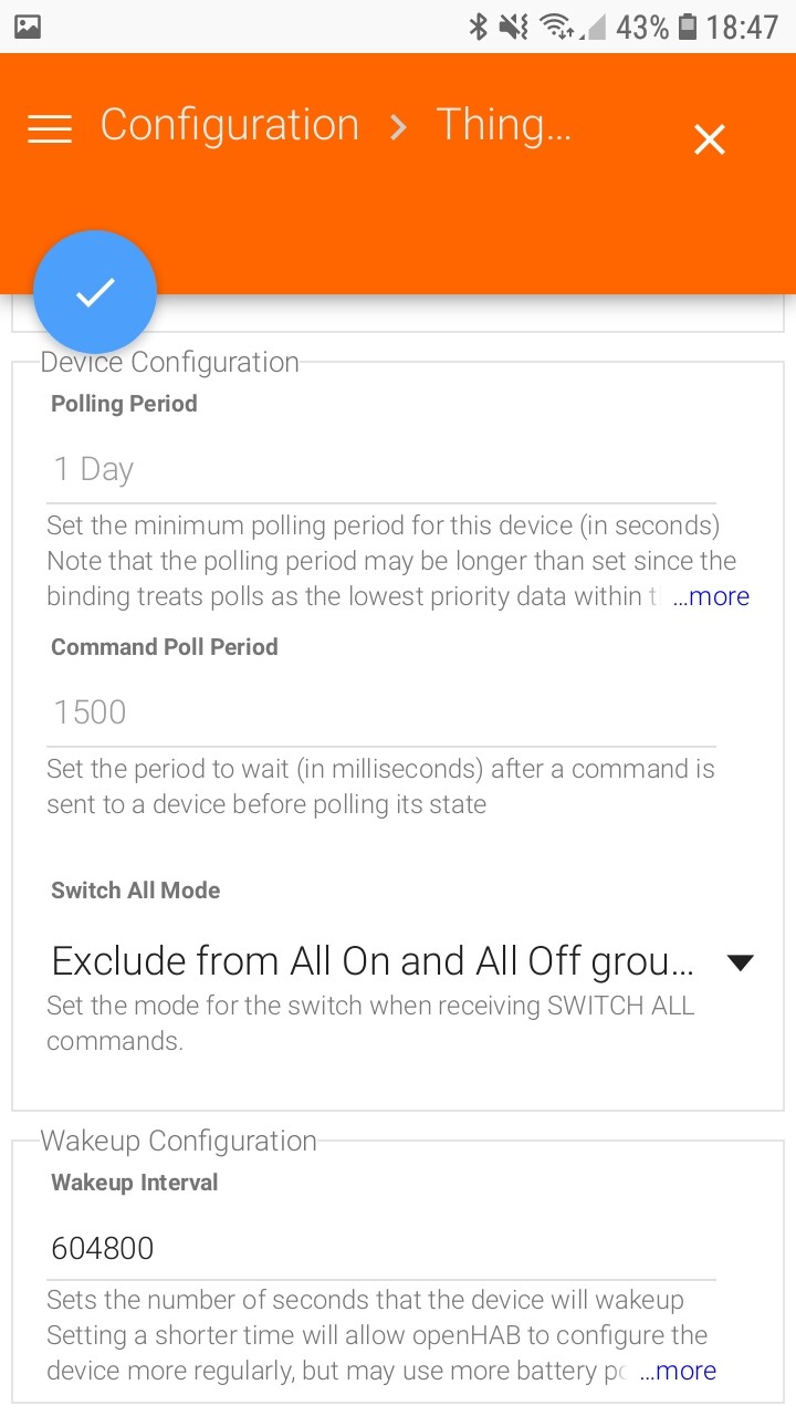

I included a Z-Wave WALLC-S wall switch (battery device) and the device is online:
grafik

I think the parameters 11-14 are the most important in this case. Here I have the option between:
|7|Control DoorLock|
|8|Central Scene to Gateway|
|0|Disabled|
|1|Switch On/Off and Dim (send Basic Set and Switch Multilevel)|
|2|Switch On/Off only (send Basic Set)|
|3|Switch All|
|4|Send Scenes|
Can anyone help me? I’m really becoming desperate…

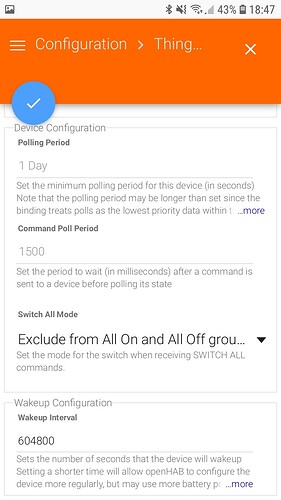

I just included the device again, now the “Node initialising: Manufacturer” doesn’t appear anymore:
grafik
As you can see, the channel looks good, or what do you mean by the channel status? Where can I see that?

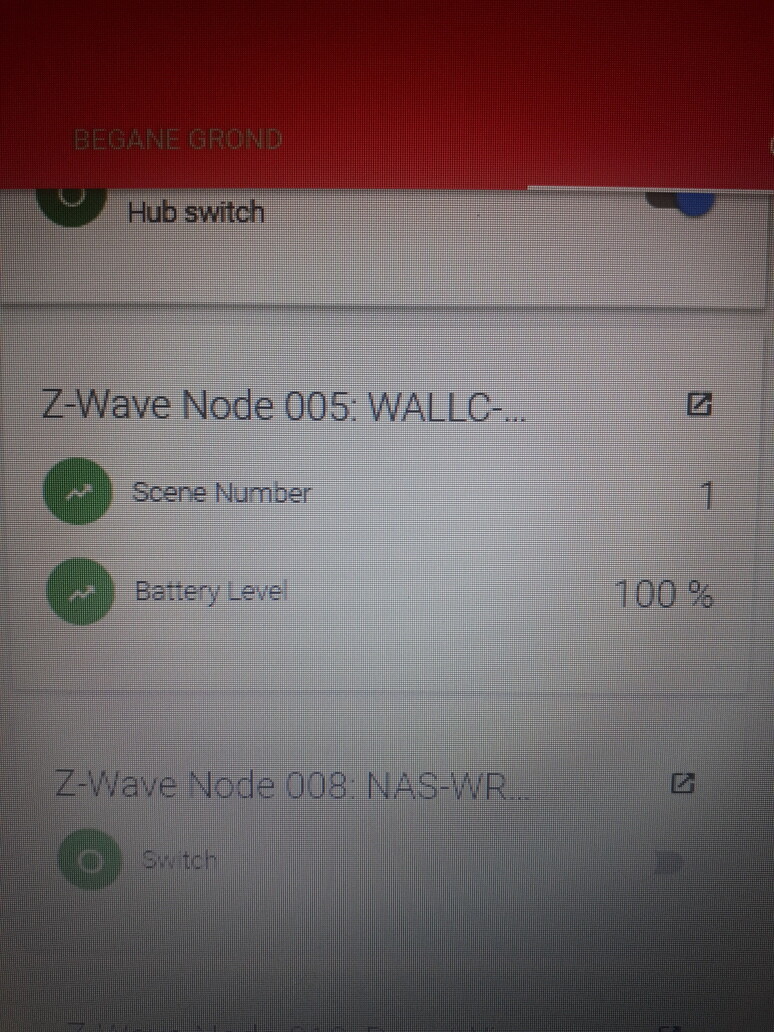

I mean, when you are in Paper Ui, click on the left on control and jou will find see your items made in paper ui.
This is my wall-c ( one of them )
20200323_220817
Do you see a Zwave thing update when you re- send node information from the wall-c ?

When pussing a button is should show a number. Battery status can take a while

Could you please send me a Screenshot of your WALLC configuration parameter, Olaf?
Thank you
Here they are.
Screenshot_20200324-184642_Firefox
Screenshot_20200324-184652_Firefox
Screenshot_20200324-184701_Firefox
Screenshot_20200324-184708_Firefox
Screenshot_20200324-184714_Firefox
Screenshot_20200324-184726_Firefox
Thank you very much. Unfortunately it doesn’t work either…
When I press a button, the red lights goes on. Maybe there is a problem with the device. I just ordered the same again to check it.
I will tell you, if it works.
Thank you very much for your help!
Where your settings different then mine ? If so, you need to wake up the device to ‘push’ the settings from openhab to the WallC. Or you need to wait until its wake-up time has expired.
If the were the same, than I don’t know.
Hopefully yours is broken, and the new will work.
Where do you buy them, I can’t find them anymore here in the Netherlands.
The settings are exactly the same and I woke up the device a few times. There was even “device updated” in the logs… I hope it’s broken, because I can’t find any “regular” alternative switches to put on the wall, do you?
