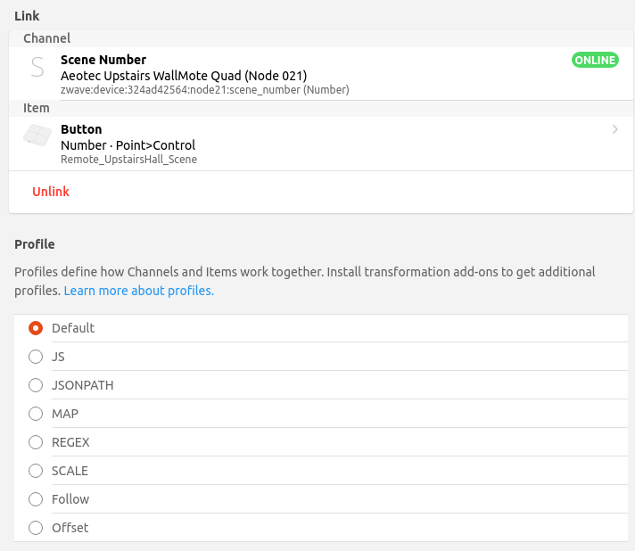

In general, with the aeotec remotes (wall motes, nano motes, etc.) it is sufficient to have the scene_number channel linked to a number item and then check that item for updates (updated instead of changed allows you to capture sequential pushes of the same button). Here’s one of my examples:

Yeah, that’ll do. You’ve connected your item to the scene_number1 channel. These devices are configured with a bunch of these scene endpoints and it gets a little murky. I’ve not had any success with the numbered scene channels (I think you may need a different configuration on the device itself to make use of them). You can get everything you need with just the general scene_number channel (see my image in the post above).
When you click any of the 4 buttons then that one channel will get a number in the format of “#.#”. The ones place is just 1 - 4 and tells you which button is sending the scene, and the tenths place is (if I recall) 0 = press released, 1 = press started, and 2 = long press being held. So a state of 2.1 means that someone just started a press in quadrant 2 and so forth.
An additional benefit here is that you only need one item for all the information coming from the device, not four different items.

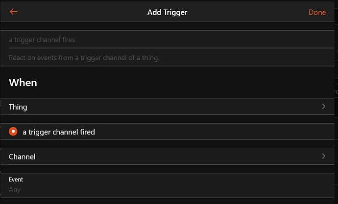

Okay, thanks… I don’t see how to add a channel to a rule. When I click “Add trigger:thing event”, I get this dialog:
So I select the first item (blank) and I get this screen:
If I click on Channel > , I get a single item list with the first item being blank (similar to the blank on top of the first image).

scene-number is not a trigger channel (so you can’t add it as a rule trigger). You still need to link an item to it, but instead of item1 … item4 linked to channels scene_number1scene_number4 you just need one single Number item linked to the general scene_number channel. That item will then receive updates as I described above of the #.# form and your rule trigger will be when that item receives an update.

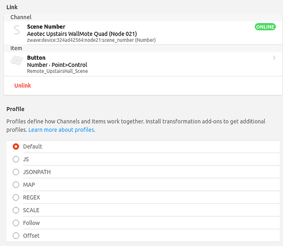

Okay, thanks, this is helping. I’m getting somewhere. I linked the Scene Number to the channel:
