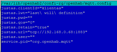

MQTT CFG:
justas.url=tcp://192.168.0.68:1883
justas.clientId=klientas
justas.user=
justas.pwd=
justas.qos=0
justas.retain=true
#justas.async=async
justas.lwt=last will definition

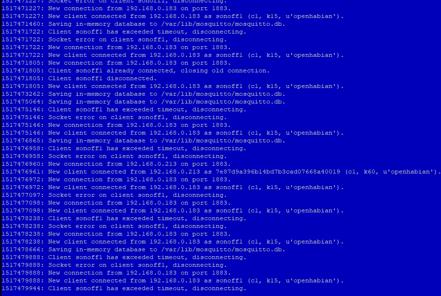

Mosquitto log fine:

Everything looks fine in mqtt.config

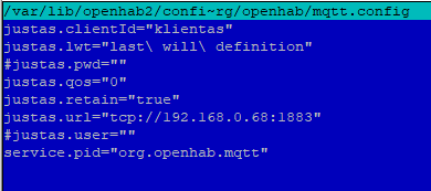

please try to comment out those two lines both in mqtt.cfg and afterwards in /var/lib/openhab2/config/org/openhab/mqtt.config, if it’s still in there.
Tried to comment with #
Then stopped/started OH service, and those lines were again with no comment sign.
So commented again but it does not help.

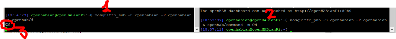

  3. try mosquitto_pub or mosquitto_sub from the commandline from your openHAB server (Shows you, whether the openHAB server can reach the broker)

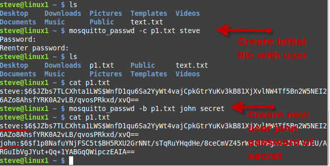

Can you explain a little more on this, what do you mean passwd-file of MQTT binding?
I enter mqtt.cfg password and user, so it knows which credentials to give for Mosquitto broker.
If you mean that picture which is in the first post of this topic, then I did create file to get “encoded” version of the password, which I did input to Mosquitto /etc/mosquitto/passwd, since then, I do not use that file. Did you mean that file?

  3. Yes I have tried that before, but here I tried that again:
Any more ideas what can be wrong here?

yes, that is exactly, what I meant! :wink:
