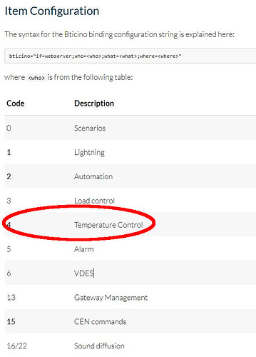

I know it… there is no refence or examples to Temperature Control and the external link is broken…
 For more details refer to the official document OpenWebNet Introduction.  <-- INVALID

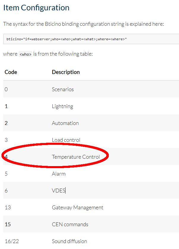

immagine
Sure but “4” is not a reference or example about “Temperature Control”.
