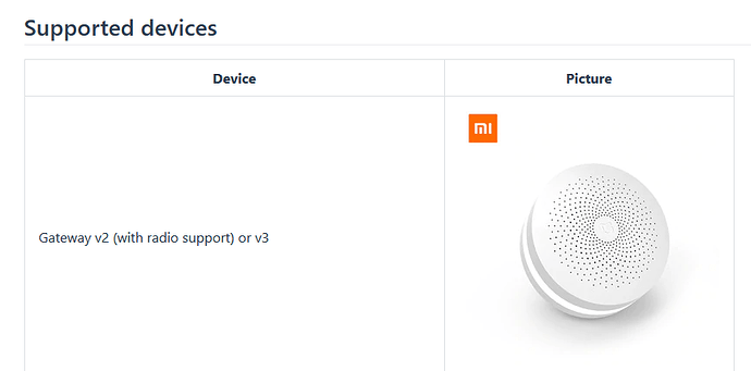

But now I have another problem. If I have understood the documentation of the binding xiaomi Mi IO Binding this gateway is not supported.
What about the mihome binding?
I made a new topic about that -here. The problem is that I can’t put the gateway in the developer mode.
