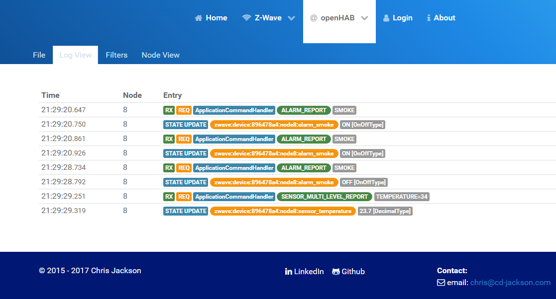

In case of smoke alarm (trigger with real smoke) in log i can see a alarm report
11:07:47 alarm report smoke - no further action
11:09:27 alarm report smoke - state update channel and the item state is set to OFF, correct
i made the changes
however you need to wait until @chris updated the binding with the last database changes
once that was done you need to un and reinstall the binding to get the new version
then delete smoke sensor (only the thing; no exlcusion needed) and readd it
then make another test with smoke and please also tell us if the test was succesful

I can confirm that a real smoke test is not triggering the ‘Smoke Alarm’ channel, while a test alarm is working properly. I am a bit surprised that an update of the database by @chris must followed by a reinstallation of the whole binding and deleting the smoke sensors. That’s quite a bit of work on my site as I am using 10 smoke sensors.
Unfortunately that’s the way the system works. The things are stored in the config database - there’s no way to update them, so you need to delete them from the system and add them back.
All right then! At least I know what’s going on. I am pretty much interested that the smoke alarm works properly when it is needed most (read: in case of a fire). I created some rules depending on this, e.g. turning on my lights and opening all rollershutters in my house. With the real smoke test I just realized that this crucial part of my smart home is not working.
Any idea when you find time to update the database?
Thanks for your support!!
Ok, if the changes have already been made then I’m currently processing the database updates right now. As I said, I hadn’t read all the messages above so didn’t follow what was needed.
