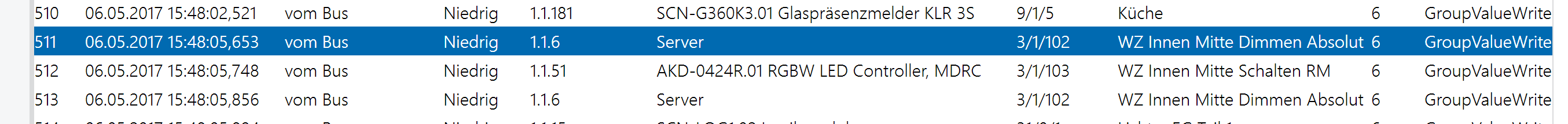

Reading values from the Bus seems to work fine, but writing to it will result in two writes.

Anyway, my items do contain the autoupdate=“true” part. If I remove it or switch to false, no write is passed to the Bus anymore, eg I can’t control the items via WebIF (BasicUI) anymore.
Same here. I have a Weinzierl EnOcean gateway, and some EnOcean dimmer show “strange” reactions when getting doubled messages from the KNX bus.

I’ve now setup my OH2 isntallation completely new, re-edited the KNX config file with just the need parameters. I’ve then tested it without any item definition: no double messages on the KNX bus. I’ve then added one item, and the the double messages are back.

OH responds with a write on the knx-bus every time something is written on the knx-bus
