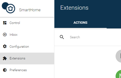

I can’t use any UI.
I’ve had this problem for a couple weeks now. Every single update fails, and I need to stop(sometime reboot), and clear out the cache and tmp directories. I’ve removed it from doing auto updates, and it renders things useless.
Even after cleaning both paths, nothing happend.

Using apt and I am getting this message (org.osgi.framework.BundleException) after I restart my OH2 Snapshot #947 (only the first time after upgrade). It’s usually the first entry in my log (although I have most of the loggers at WARN level).
Edit: Clearing out tmp & cache actually solved the problem! (in my case)
The message disappeared and PaperUI works fine and as expected (orange theme instead of blue and it shows up in the index/start page)
Without clearing tmp & cache, the problem remained the same (at every restart).

I stop OH2, clear manually everything within the tmp & cache folders, then start OH2: All ok
After upgrading to new version and cleaning tmp & cache folders, i can’t use any UI.

My PaperUI looks like this:
And BasicUI looks like this:
I tried to solve it by clearing the cache and rebooting. It didn’t solve it.
Does anyone else have this problem?
