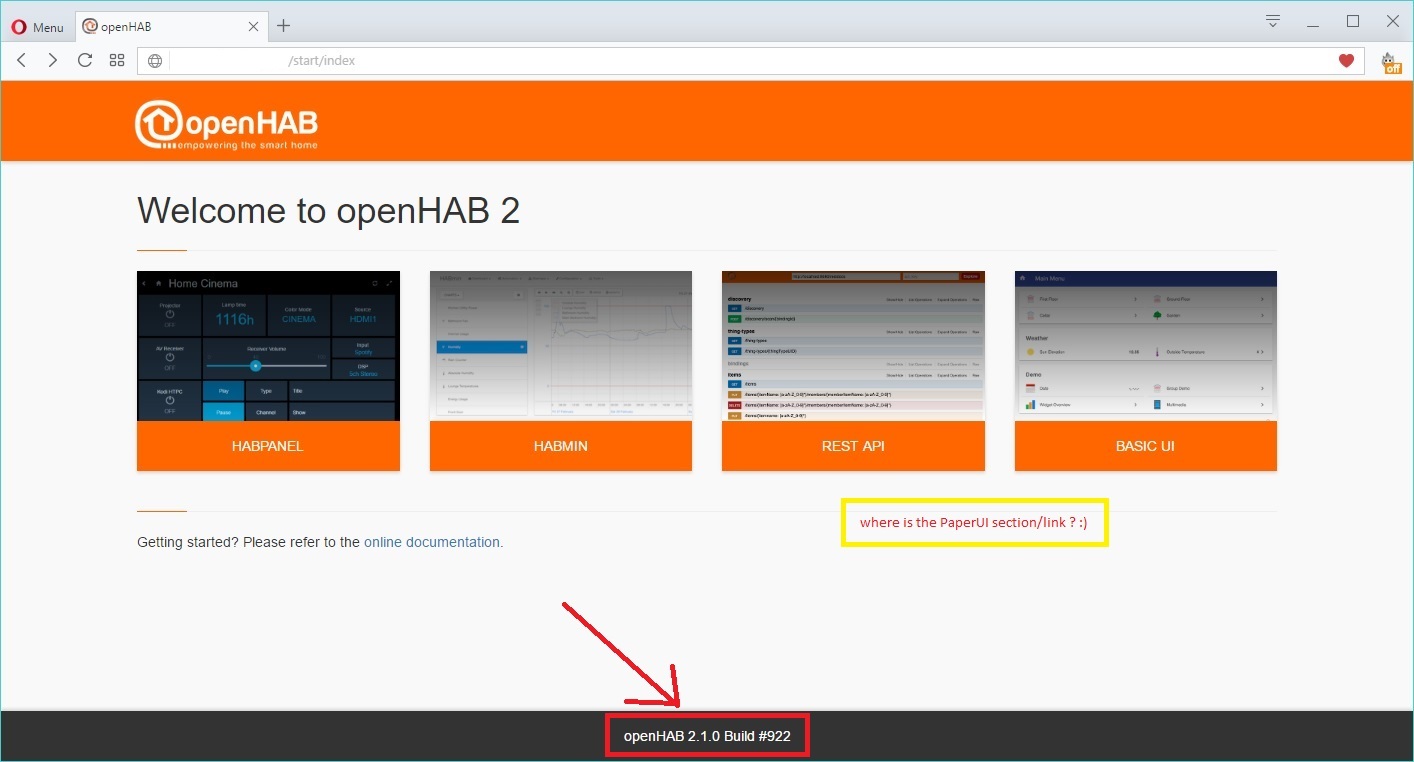

But (if I am not wrong)… the Start Page (http://<OH2_IP>:8080//start/index) has a bug in OH2S922… It doesn’t show the link to PaperUI…
If I navigate directly to http://<OH2_IP>:8080/paperui/index.html everything is ok.
This is my addons.cfg entry: ui = basic,paper,habpanel,habmin & misc = restdocs,homekit

Maybe I should open up a new issue? @Kai
I just tested #924 and cannot confirm any issue - all works as before.
Your exception sounds a bit like this one, though. But as you are not using the new rule engine in your setup, this should not be directly related. @sjka Do you maybe have any idea what might cause this exception (and as a result does not start the Paper UI fragment correctly)?
