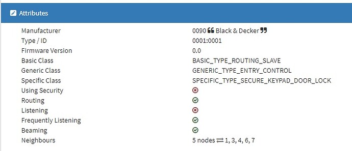

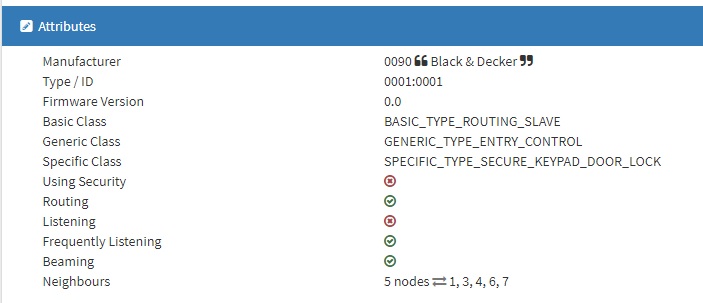

I have a hard time including my kwikset 910 in the network. I have openhabian built with Z-stick5. I’ve read a lot on this forum but i can’t get it work. I have 3 dimmer and 1 power plug working flawlessly!
I installed this addon: org.openhab.binding.zwave-2.2.0-SNAPSHOT. I added the security key to the z-stick.
Last thing i done is removing the thing (kwikset) from habmin, then deleting .xml file. I removed the lock from the network with the z-stick. Reboot openhabian. I added the lock back with the z-stcik, put it back in the pi. (The zwaveLog.pdf start here) Then i added the thing in habmin, node 11. I saw that it didn’t use security so i rebooted openhabian again with no change.
This image is what i got now.
Do i need to edit the .xml file with the security key or something?

You can’t do this. The stick needs to be plugged into the computer to do secure inclusion.
Thank you for this!!!
I’ve been messing around all afternoon trying to securely include my Kwikset 910 lock with no success. My network has only 5 nodes, but I was unable to securely include my lock in OH. I did a factory reset on the device - no luck. I removed the lock from the door in order to get it close to the controller – no luck. I tried all settings for inclusion mode – Network Wide, High Power, and Low Power - no luck.
Then I decided to try your method. I followed your steps and it worked flawlessly on the first try!
Try this. It worked for me on the first try.

So for people in my situation : I deleted the thing, delete node11.xml, restart openhab and remove doorLock from zwave network with z-stick in hand. Then i plugged back the z-stick to the Pi and played with the daugther till bedtime (45ish minutes). Then i did an inclusion with habmin and voilà! The doorlock appeared and was using security.
Thank you so much and thanks Chris for you time with this addon!
