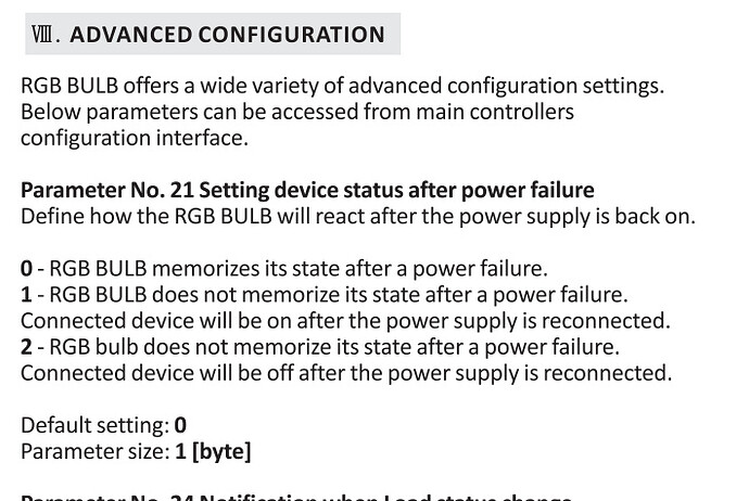

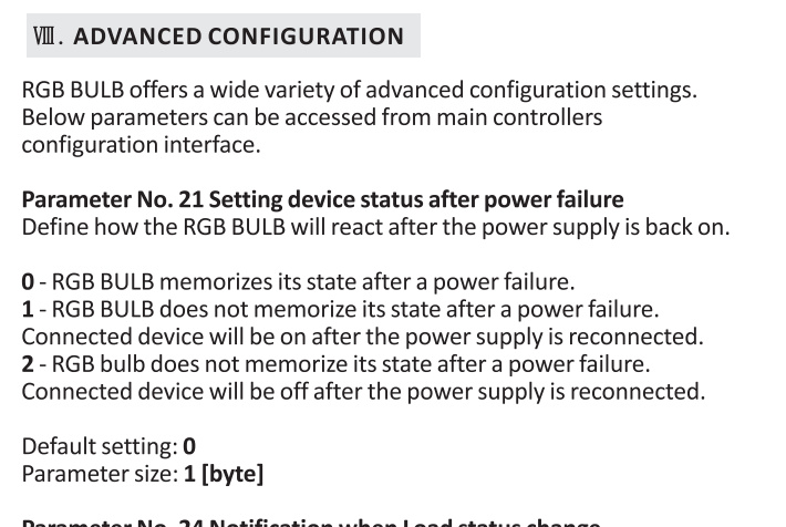

It’s nothing to do with the specs. The configuration parameters are device dependant and are normally specified by the manufacturer.
Ok…

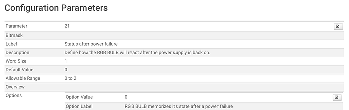

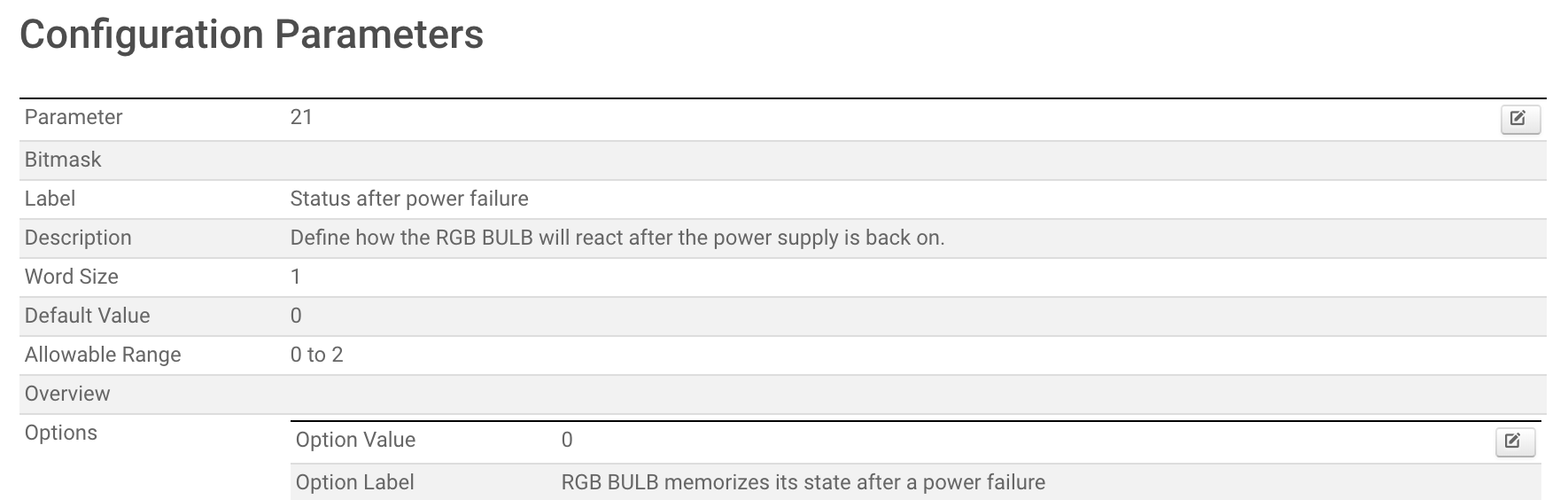

In the database, there is an area called Configuration Parameters -:
This information comes from the device manual -:
Question - is it the same for the two devices…

As for the entries, it’s almost an exact match but the database entry has a few advanced features my manual doesn’t list (for instance parameter 51 and 61). Considering they are the exact same model number and revision I expect it’s the same. I think this is a case of a chinese product being remanufactured or rebadged for other brands.
