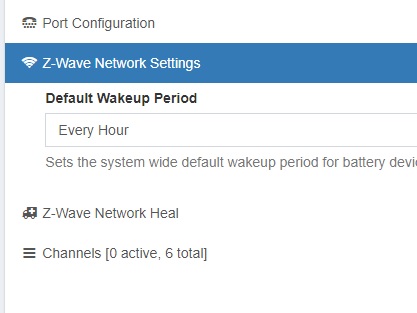

New install on Windows and I haven’t had any luck with Z-Wave. Seeing ksarauer’s screenshot made me look at my controller in “things” and I don’t have any of the same network settings.
It is an aeotec z-stick gen5 on OpenHAB 2.2 and using this new z-wave binding.
Here is what I see for settings.
That would be quite strange - I suspect you are not showing the advanced options? If not, select advanced mode in the menu.

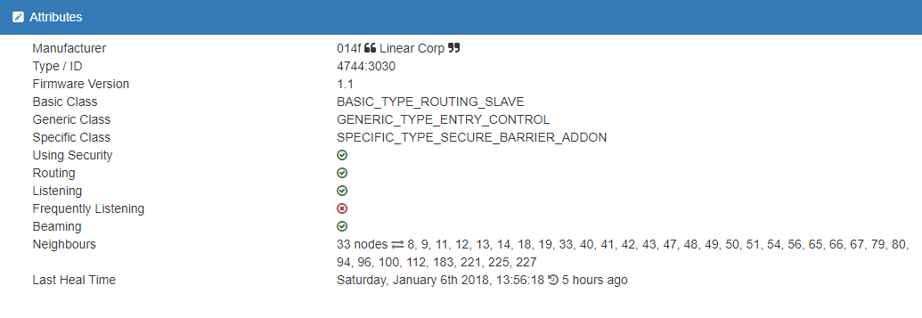

Here is my detached garage door opener, which is the furthest device from the controller (definitely out of range). It works great through the mesh.
