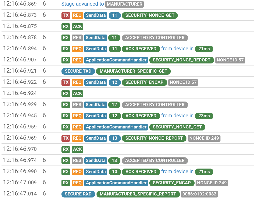

A single entry from the log isn’t so useful - security transactions involve multiple packets.
Fair enough, here’s a more full log: Dropbox - Error - Simplify your life
My basic understanding of what is happening is that the inclusion succeeds up to REQUEST_NIF, at which point the binding no longer seems to be able to communicate with the node. Any time I manually re-wake the node, that sequence at the end repeats (ending with the NONCE error), and the binding concludes that the node is asleep.
It’s strange if that is the case as the binding should not request a NIF after a device is included.

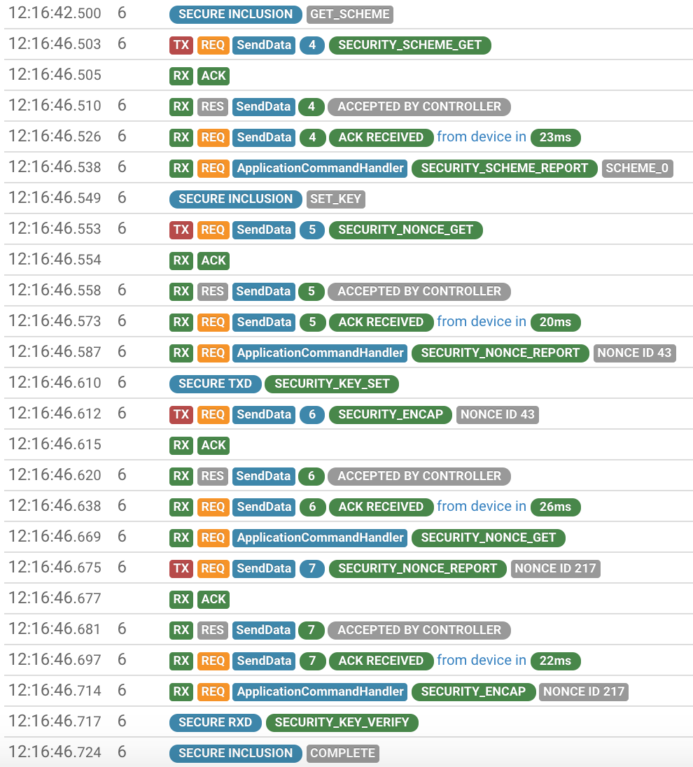

The earlier log of yours that I looked at the secure inclusion started fine - the device reported back that it was using key-0 and then it stopped responding. I’ll check this log…
In your latest log the device has securely included ok.
After this the interrogation starts - it looks ok and it will take some time. It’s especially slow with security enabled as every request results in two or three transactions due to the security protocol - it’s all working ok though -:
(this is just an example transaction - the rest also look ok).
The nonce errors can happen occasionally, but this is after the inclusion process completes. I see no issue with the REQUEST_NIF that you mentioned - yes, it’s currently at that point, but it looks like you probably restarted the binding, so now the interrogation has to restart from the beginning as it didn’t complete the first time.
Currently it looks ok from this log and secure inclusion worked fine. The device will currently be asleep after the binding restart - try waking it up and see what happens.
