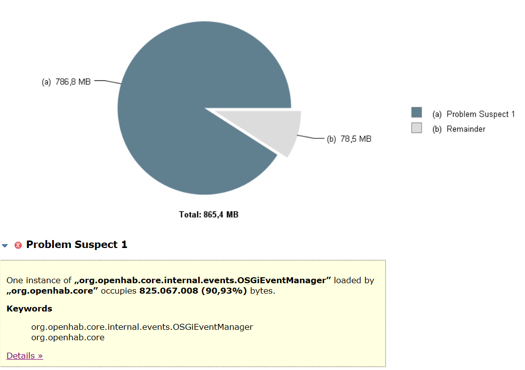

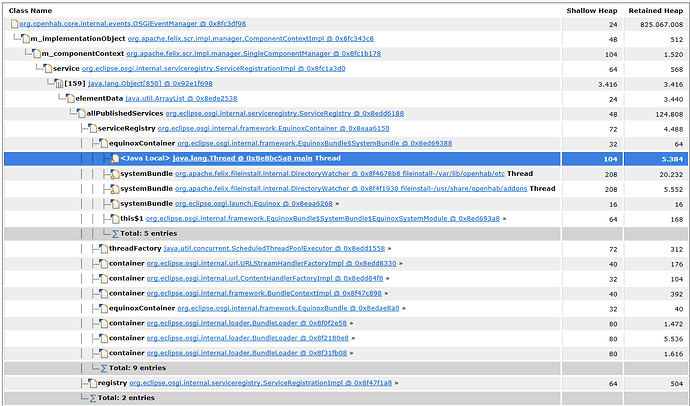

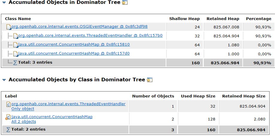

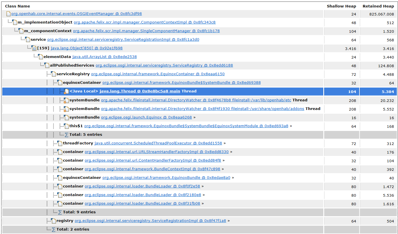

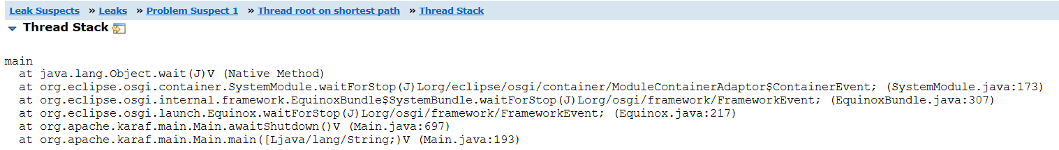

Dear all, I’ve had in the past some issues with out of memory errors, where I added the rule to create a heapdump on out of memory errors. Luckily the error was out for quite some time, but 2 weeks ago during my holiday the out of memory error occurred again.
I was able to restart OH remotely, so the system continued with it presence simulation again and is running for about a week again.
Unfortunately don’t have the logs anymore, though the heapdump was created. Tried to understand a bit from it by using MemoryAnalyser, though unfortunately I don’t have any clue where to start looking.
Barely have any rules active, since I do use NodeRed for my automation.
I don’t see any hints to a certain binding or so in the analysis.
Somebody able to help me a step further where to continue my investigation?

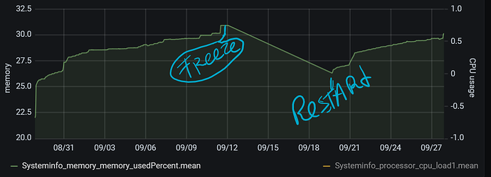

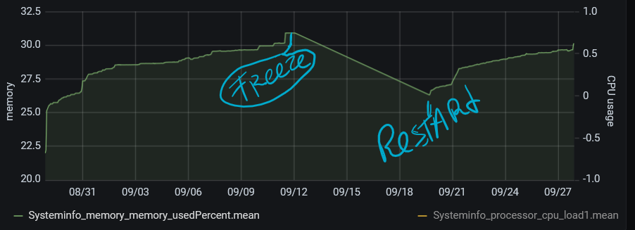

Some screenshots:
Below a screenshot of the event in the monitoring, it took me a few days before recognizing the system didn’t worked anymore.
Java does not use your ram like other programs, it uses a small piece of your ram called the heap. What do you have your heap size set to? What is the output of ‘shell:info’ in the openhab console after a restart and also after it has been running for a few days?
Most likely your openHAB runs out of memory because the OSGiEventManager is no longer processing events. If events are no longer processed the events queue in the OSGiEventManager will grow endlessly. So running out of memory is merely a side effect of the thread (that would process the events) being dead or blocked.
Next time when the issue occurs, you can see what the thread is doing by creating a thread dump on the Console with: threads --locks --monitors
The thread that does the processing has OH-OSGiEventManager as name.

Thnx both for the reply’s!

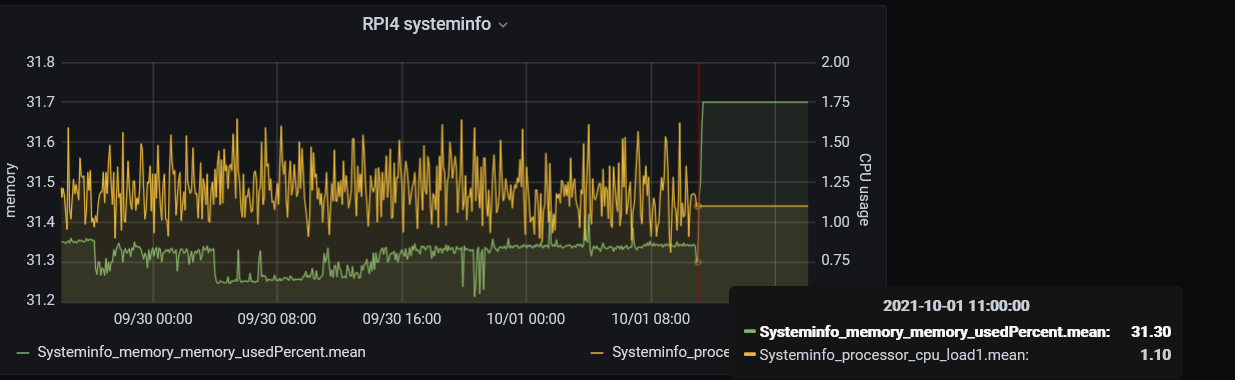

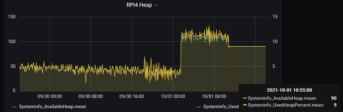

Thanks! Added both channels, current heap level is between 2-8% [25-75MB] in the first 15 minutes. Will let it run a couple of days.
I have looked at dumps before and sadly they are limited in usefulness because everything that runs in openHAB shows up as the same process. You can not get a ‘X binding’ or its is a rule that is the cause. You can look to see how many byte vs strings and other variable types there are and how much data they hold, but a static look is not much help unless you compare to a system just booted and run for a few minutes. Knowing that the total amount of byte is growing can be useful to know, but if you dont know which binding to look at or make a report against it is of limited value…
Best to disable rules and bindings one by one until the issue stops so the cause is known. If you can see the issue in realtime, it helps speed up the process and downtime of looking.
What the heap should look like, note that each time the garbage collection is done, the heap returns to the same value.
What to look out for if there is a memory leak. Note how the leak means the heap is not cleaned and it is increasing over time. You may find that it only occurs when you use a certain feature that the heap does not return back to its normal average amount.
https://akshaymathur.space/wp-content/uploads/2019/11/MemoryLeakHeapUsage.png
This is a serious leak, and most likely you wont notice it growing until you look at the graphs over a few days, or it may only grow when a feature is used.
Hopefully it shows something.
It will also help to see what all other threads are doing. Then if the thread processing events is waiting for a lock hold by another thread, we can see what that other thread is doing and why it is not releasing the lock.
OK thanks for the explanation. Thought there could be some indication (once Iohaf issues with the zwave binding caused by a dead node and it indicated zwave).

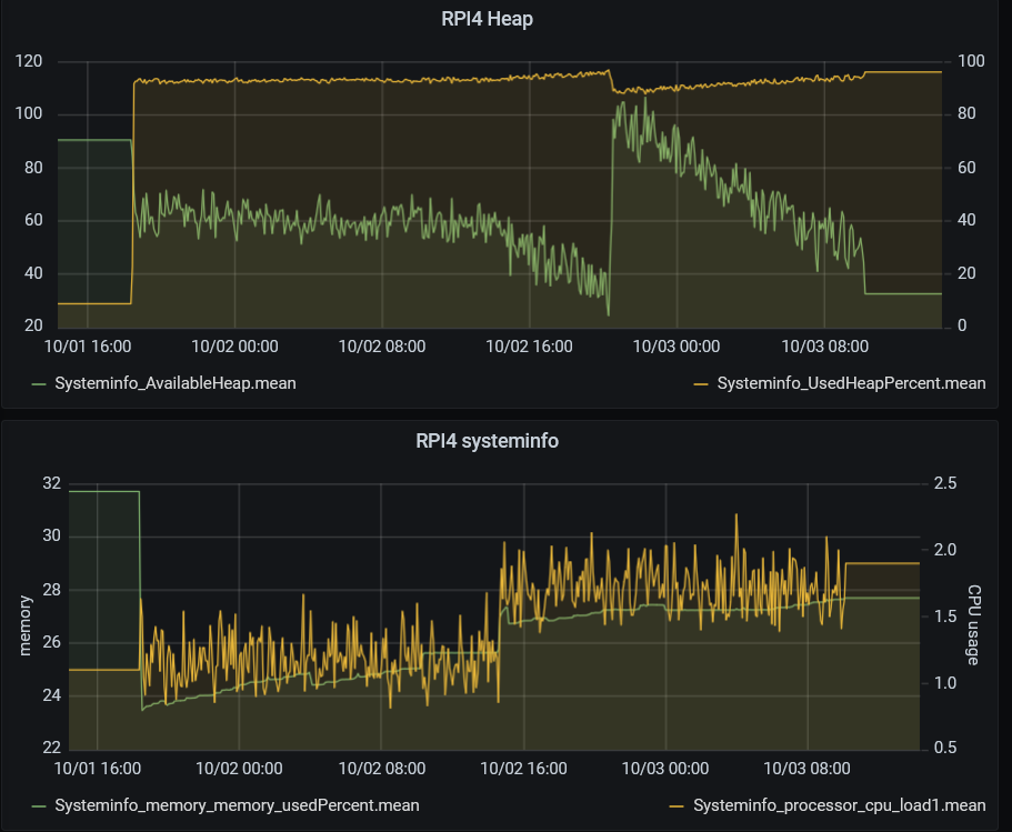

After 24h it seems normal, but just keep an eye on it. For sure the graphs will help connecting the issue to a certain event or occurance.
The system stopped working today, so below I will post all the information guarded. For some reason the dashboard is still available, but no physical response to any command.

The heap graph may be showing your system has a gradual leak over the first half, need to watch over a greater time frame, but forget this for now and come back to it later… Then you notice the way you were using the system changed, maybe a new feature was used at that point, this is normal. Then the big sharp spike from something major failing and the garbage collection grabbed back a lot of memory. This will be the thread that processes the events getting cleaned up. Guessing the graph stopped working as it needs the events to be processed to work. When that occurred I would be expecting to see an ERROR in the logs, did nothing show up? Did the WARN about OutOfMemoryError fill the log and push all ERROR messages away? There can be a log rotation where when the logs reach a certain size they are saved to a separate file with a incrementing number added.
Thnx, additional entries are created in the console. Will post again the result when available.
edit: Now I am getting like 100 entries per second in the log file, is this not creating other issues?
Used the new binding version, let’s see how the full graph is developing now.
No other ERRORS in the log around the time the graph stopped. I have some regular errors from the modbus not able to read the SDM120 electricity meter. But this is ‘normal’ for some years now, I’ve seen more people here having issues with that.
Indeed needed to check the log rotation files already, since there where a couple of hours passing between the issue occuring and me being back at home.

System crashed (it seems to happen more quick now then before).
Attached the latest two log files, didn’t filter anything so you are able to see every entry in the logs, though the rotation file was way to big to upload it, so it is zipped. After downloading change the extension back to .zip.
openhab.log (88.5 KB)
openhab-rotation-zip.txt (736.7 KB)
Around 10:15, when the issue occured, I arrived at home so actually everything happened at once. Radio started and the light scenes where activated, both triingering zwave and RfLink to work.
