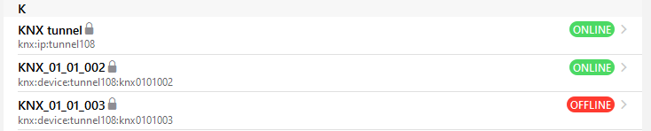

Hi all,
still havig trouble with textual files in openHAB 3.1.0 Build #2107
DEvice is offline
afbeelding
my things file
Thing knx:device:tunnel108:knx0101002 "KNX_01_01_002" (knx:ip:tunnel108) @ "WC"
        address="1.1.2",
        fetch=false,
        pingInterval=300,
        readInterval=3600
         // bediening
        Type switch     :   sw09    "licht wc (sw09)"                   [ga="0/1/1+<0/1/101"]
        Type switch     :   sw10    "licht boven spiegel (sw10)"        [ga="0/1/2+<0/1/102"]
        Type switch     :   sw11    "ventilator (sw11)"                 [ga="0/1/3+<0/1/103"]
        // status terugmelding
        Type switch    :   st09    "status licht wc (st09)"             [ga="0/1/101"]
        Type switch    :   st10    "status licht boven spiegel (st10)"  [ga="0/1/102"]
        Type switch    :   st11    "status ventilator (st11)"           [ga="0/1/103"]

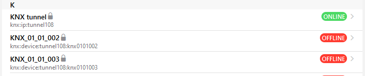

when removing
            address="1.1.2",
            fetch=false,
            pingInterval=300,
            readInterval=3600
the device comming online
afbeelding
any idea what be the correct syntax has to be

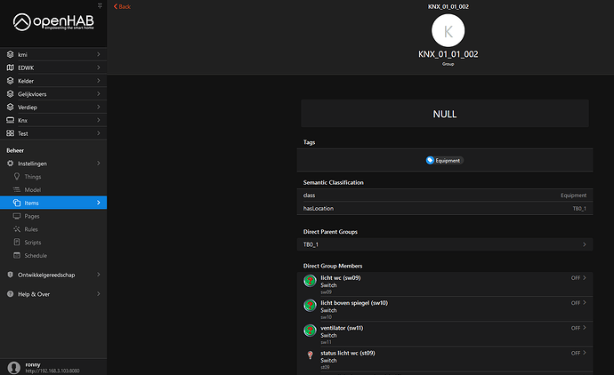

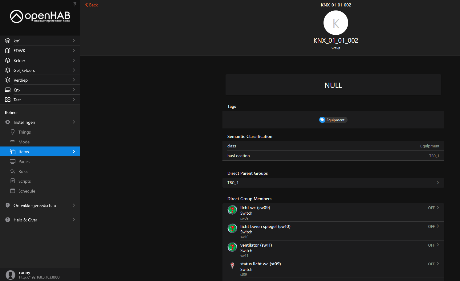

Hi all,
After reading and trying everything, I still haven’t found the tree in the forest :slight_smile:
afbeelding
my changed items file
Switch      sw09    "licht wc (sw09) [%s]"                      <button01>  (KNX_01_01_002) ["point"]  {channel="knx:device:tunnel108:knx0101002:sw09"}    Switch      sw10    "licht boven spiegel (sw10) [%s]"           <button01>  (KNX_01_01_002) ["point"] {channel="knx:device:tunnel108:knx0101002:sw10"}    Switch      sw11    "ventilator (sw11) [%s]"                    <button01>  (KNX_01_01_002) ["point"] {channel="knx:device:tunnel108:knx0101002:sw11"}    Switch      st09    "status licht wc (st09) [%s]"               <lampgeel>  (KNX_01_01_002) ["point"] {channel="knx:device:tunnel108:knx0101002:st09"}   Switch      st10    "status licht boven spiegel (st10) [%s]"    <lampgeel>  (KNX_01_01_002) ["point"] {channel="knx:device:tunnel108:knx0101002:st10"}    Switch      st11    "status ventilator (st11) [%s]"             <lampgeel>  (KNX_01_01_002) ["point"] {channel="knx:device:tunnel108:knx0101002:st11"}

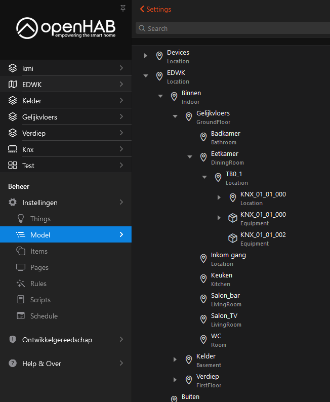

the model
afbeelding
afbeelding

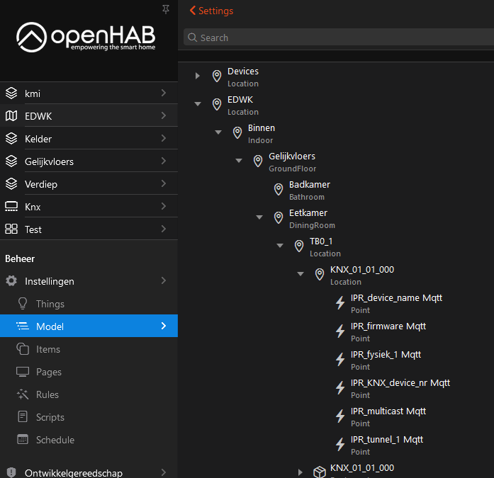

Question,
points created in the ui3 are visible in model, those with textual files not
afbeelding
is still missing something :frowning:
regards
Ronny
