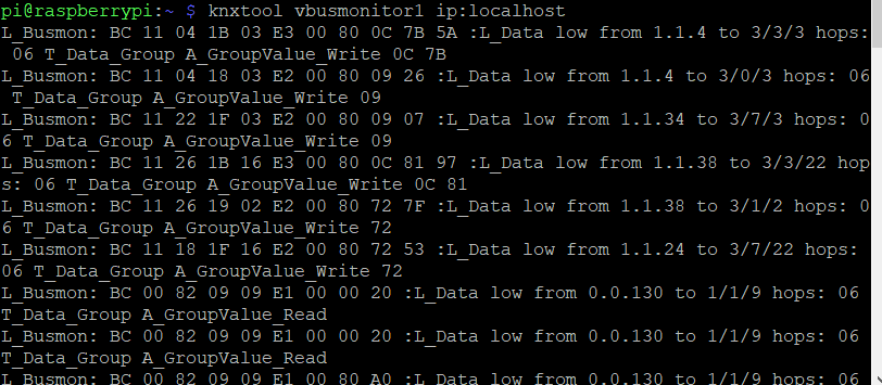

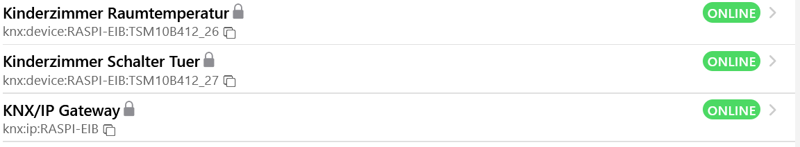

For a time after restart all is good but after a day or may two, they are no connection possible without restart of OpenHab. The Binding showa online but it is not online!
If i try to switch light, nothing happens! With ETS 5.0 and Groupmonitor is switching possible
and in knxtool vbusmonitor i can see all from ETS but nothing from Openhab.

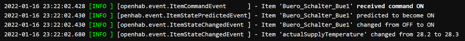

In Logtail i see this, when i try to switch something.

after testing to find the problem, i observe the following:
  • after one day the responding of KNX binding dont work in both directions
  • i can only switch off light with OH GUI but no more switch on
  • i can switch with KNX ETS on and off without problems
  • after i “pause” the switch in OH GUI and “resume”, i can switch off and on light
  • the command to switch on light, isn`t shown in logtail, when the malfunction exist. Only the switch off command ist shown in logtail
  • after i restart the switch in OH GUI, all commands shown in logtail.
