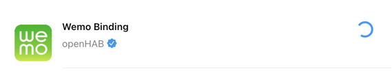

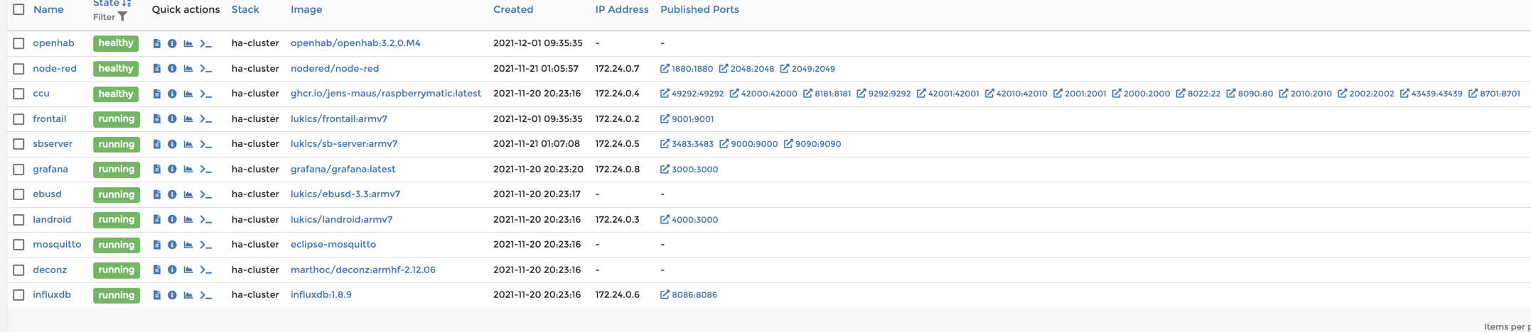

I found some resources on the web and tried following:
logedin into the production openhab container
docker exec -i openhab bash
updated the packed and installed npm, nano and the " node wemo-client"
apt update
apt install npm nano
npm install wemo-client
I copied the wemo test node script into local wemo.js:
var Wemo = require('wemo-client');
var wemo = new Wemo();
wemo.discover(function(err, deviceInfo) {
console.log('Wemo Device Found: %j', deviceInfo);
// Get the client for the found device
var client = wemo.client(deviceInfo);
// You definitely want to listen to error events (e.g. device went offline),
// Node will throw them as an exception if they are left unhandled
client.on('error', function(err) {
console.log('Error: %s', err.code);
// Handle BinaryState events
client.on('binaryState', function(value) {
console.log('Binary State changed to: %s', value);
// Turn the switch on
client.setBinaryState(1);
ran the wemo.js
root@vevedock-pro:/openhab# node wemo.js
Wemo Device Found: {"deviceType":"urn:Belkin:device:insight:1","friendlyName":"weihnachtsbaum","manufacturer":"Belkin International Inc.","manufacturerURL":"http://www.belkin.com","modelDescription":"Belkin Insight 1.0","modelName":"Insight","modelNumber":"1.0","modelURL":"http://www.belkin.com/plugin/","serialNumber":"221449K1200DCF","UDN":"uuid:Insight-1_0-221449K1200DCF","UPC":"123456789","macAddress":"94103E3E26EC","firmwareVersion":"WeMo_WW_2.00.11532.PVT-OWRT-Insight","iconVersion":"1|49153","binaryState":"0","binaryOption":"1","new_algo":"1","iconList":{"icon":{"mimetype":"jpg","width":"100","height":"100","depth":"100","url":"icon.jpg"}},"serviceList":{"service":[{"serviceType":"urn:Belkin:service:WiFiSetup:1","serviceId":"urn:Belkin:serviceId:WiFiSetup1","controlURL":"/upnp/control/WiFiSetup1","eventSubURL":"/upnp/event/WiFiSetup1","SCPDURL":"/setupservice.xml"},{"serviceType":"urn:Belkin:service:timesync:1","serviceId":"urn:Belkin:serviceId:timesync1","controlURL":"/upnp/control/timesync1","eventSubURL":"/upnp/event/timesync1","SCPDURL":"/timesyncservice.xml"},{"serviceType":"urn:Belkin:service:basicevent:1","serviceId":"urn:Belkin:serviceId:basicevent1","controlURL":"/upnp/control/basicevent1","eventSubURL":"/upnp/event/basicevent1","SCPDURL":"/eventservice.xml"},{"serviceType":"urn:Belkin:service:firmwareupdate:1","serviceId":"urn:Belkin:serviceId:firmwareupdate1","controlURL":"/upnp/control/firmwareupdate1","eventSubURL":"/upnp/event/firmwareupdate1","SCPDURL":"/firmwareupdate.xml"},{"serviceType":"urn:Belkin:service:rules:1","serviceId":"urn:Belkin:serviceId:rules1","controlURL":"/upnp/control/rules1","eventSubURL":"/upnp/event/rules1","SCPDURL":"/rulesservice.xml"},{"serviceType":"urn:Belkin:service:metainfo:1","serviceId":"urn:Belkin:serviceId:metainfo1","controlURL":"/upnp/control/metainfo1","eventSubURL":"/upnp/event/metainfo1","SCPDURL":"/metainfoservice.xml"},{"serviceType":"urn:Belkin:service:remoteaccess:1","serviceId":"urn:Belkin:serviceId:remoteaccess1","controlURL":"/upnp/control/remoteaccess1","eventSubURL":"/upnp/event/remoteaccess1","SCPDURL":"/remoteaccess.xml"},{"serviceType":"urn:Belkin:service:deviceinfo:1","serviceId":"urn:Belkin:serviceId:deviceinfo1","controlURL":"/upnp/control/deviceinfo1","eventSubURL":"/upnp/event/deviceinfo1","SCPDURL":"/deviceinfoservice.xml"},{"serviceType":"urn:Belkin:service:insight:1","serviceId":"urn:Belkin:serviceId:insight1","controlURL":"/upnp/control/insight1","eventSubURL":"/upnp/event/insight1","SCPDURL":"/insightservice.xml"},{"serviceType":"urn:Belkin:service:smartsetup:1","serviceId":"urn:Belkin:serviceId:smartsetup1","controlURL":"/upnp/control/smartsetup1","eventSubURL":"/upnp/event/smartsetup1","SCPDURL":"/smartsetup.xml"},{"serviceType":"urn:Belkin:service:manufacture:1","serviceId":"urn:Belkin:serviceId:manufacture1","controlURL":"/upnp/control/manufacture1","eventSubURL":"/upnp/event/manufacture1","SCPDURL":"/manufacture.xml"}]},"presentationURL":"/pluginpres.html","host":"192.168.3.83","port":"49153","callbackURL":"http://192.168.3.140:32869"}
Wemo Device Found: {"deviceType":"urn:Belkin:device:insight:1","friendlyName":"Weihnachtsstrauch Terasse","manufacturer":"Belkin International Inc.","manufacturerURL":"http://www.belkin.com","modelDescription":"Belkin Insight 1.0","modelName":"Insight","modelNumber":"1.0","modelURL":"http://www.belkin.com/plugin/","serialNumber":"221501K12005EF","UDN":"uuid:Insight-1_0-221501K12005EF","UPC":"123456789","macAddress":"94103E3EA21C","firmwareVersion":"WeMo_WW_2.00.11532.PVT-OWRT-Insight","iconVersion":"1|49153","binaryState":"0","binaryOption":"1","new_algo":"1","iconList":{"icon":{"mimetype":"jpg","width":"100","height":"100","depth":"100","url":"icon.jpg"}},"serviceList":{"service":[{"serviceType":"urn:Belkin:service:WiFiSetup:1","serviceId":"urn:Belkin:serviceId:WiFiSetup1","controlURL":"/upnp/control/WiFiSetup1","eventSubURL":"/upnp/event/WiFiSetup1","SCPDURL":"/setupservice.xml"},{"serviceType":"urn:Belkin:service:timesync:1","serviceId":"urn:Belkin:serviceId:timesync1","controlURL":"/upnp/control/timesync1","eventSubURL":"/upnp/event/timesync1","SCPDURL":"/timesyncservice.xml"},{"serviceType":"urn:Belkin:service:basicevent:1","serviceId":"urn:Belkin:serviceId:basicevent1","controlURL":"/upnp/control/basicevent1","eventSubURL":"/upnp/event/basicevent1","SCPDURL":"/eventservice.xml"},{"serviceType":"urn:Belkin:service:firmwareupdate:1","serviceId":"urn:Belkin:serviceId:firmwareupdate1","controlURL":"/upnp/control/firmwareupdate1","eventSubURL":"/upnp/event/firmwareupdate1","SCPDURL":"/firmwareupdate.xml"},{"serviceType":"urn:Belkin:service:rules:1","serviceId":"urn:Belkin:serviceId:rules1","controlURL":"/upnp/control/rules1","eventSubURL":"/upnp/event/rules1","SCPDURL":"/rulesservice.xml"},{"serviceType":"urn:Belkin:service:metainfo:1","serviceId":"urn:Belkin:serviceId:metainfo1","controlURL":"/upnp/control/metainfo1","eventSubURL":"/upnp/event/metainfo1","SCPDURL":"/metainfoservice.xml"},{"serviceType":"urn:Belkin:service:remoteaccess:1","serviceId":"urn:Belkin:serviceId:remoteaccess1","controlURL":"/upnp/control/remoteaccess1","eventSubURL":"/upnp/event/remoteaccess1","SCPDURL":"/remoteaccess.xml"},{"serviceType":"urn:Belkin:service:deviceinfo:1","serviceId":"urn:Belkin:serviceId:deviceinfo1","controlURL":"/upnp/control/deviceinfo1","eventSubURL":"/upnp/event/deviceinfo1","SCPDURL":"/deviceinfoservice.xml"},{"serviceType":"urn:Belkin:service:insight:1","serviceId":"urn:Belkin:serviceId:insight1","controlURL":"/upnp/control/insight1","eventSubURL":"/upnp/event/insight1","SCPDURL":"/insightservice.xml"},{"serviceType":"urn:Belkin:service:smartsetup:1","serviceId":"urn:Belkin:serviceId:smartsetup1","controlURL":"/upnp/control/smartsetup1","eventSubURL":"/upnp/event/smartsetup1","SCPDURL":"/smartsetup.xml"},{"serviceType":"urn:Belkin:service:manufacture:1","serviceId":"urn:Belkin:serviceId:manufacture1","controlURL":"/upnp/control/manufacture1","eventSubURL":"/upnp/event/manufacture1","SCPDURL":"/manufacture.xml"}]},"presentationURL":"/pluginpres.html","host":"192.168.3.79","port":"49153","callbackURL":"http://192.168.3.140:32869"}
Binary State changed to: 1
Binary State changed to: 8
I can see that out of the openhab container the UPnP is working.
I do not have any idea, what to do next.
