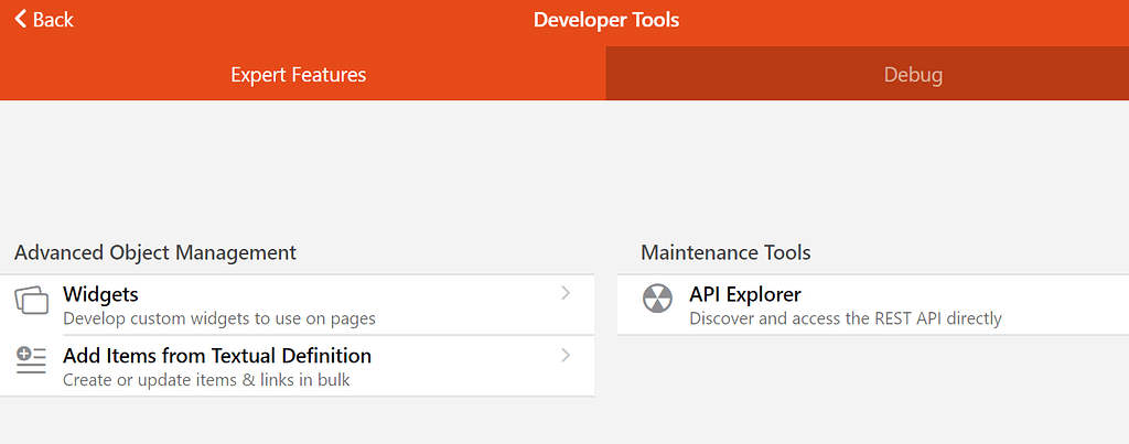

Dear all, during migrating from OH2.5 to OH3 I had some issues to maintain the patterns via “Add items via textual definition”. After longer searching and playing and shouting and playing again, I found a solution, I’d like to share. Maybe it is helpful for someone else.
In short
I’d like to import all items from *.items-files OH2.5 to OH3.0 via “Add items from textual definition”. But patterns have been ignored.
What I tried and how I solved it
Keeping the *.item files under OH3 works fine.…
More precisely:
The trick is, to add the pattern as metadata in the textual definition. E.g. , stateDescription=" "[ pattern="%1$tR" ]
(Make sure you have a space or some other text in stateDescription=" " / Empty does not work)
(The example successfully assigns and properly configures the custom temperature_list
widget for list items, but skips the offending stateDescription
metadata definition block.)
It however works when adding a single space between the pair of double quotes.
