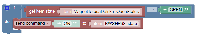

Hello everyone,
I am trying to Blockly such a thing:
when window status is open
wait 10 minutes
switch on the light.
I suppose I cant do it with Rules, therefore I am trying to do it second easiest way: Blockly
I cant even do the simple thing in blockly - without 10 minutes timer:
if (itemRegistry.getItem('MagnetTerasaDetska_OpenStatus').getState() == 'OPEN') {
  events.sendCommand('BWSHP63_state', 'ON');
or graphical:
Is the state OPEN a variable, or a text? what about the command? is it simply text, or should it be variable? And what about command ON - text, or variable?
what about MagnetTerasaDetska_OpenStatus - should I do it with get item state, or simply without?
I have tried all the combinations, nothing works.
I know, beginners question, but I havent found any answer how to do it. Those are basic principles, which I need to understand.
Thanks for help!

Blockly does not yet support creating timers nor does it support Thread.sleep.
A text constant, sometimes called a “string literal”. It is not a variable.
Also a String literal.
In this context using string literals are just fine. You’d only need to create a variable if you wanted to save a value and reuse it in multiple places, or if you want to gradually build up a value step by step or something like that.

But then I have a question - what is wrong on my Blockly without timer? Mine is not working at all. And it looks very similar to your script without timer? :confused:
What triggers your rule? You might want choose triggering by a change in that Item.
An Aquara magnet on window. So how it should look like in Blockly?

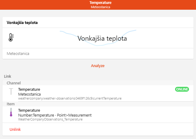

WeatherCompanyObservations_Temperature is an item with one channel:
Thanks guys!
Your Item is a Number:Temperature type, with units that are part of the value. You are comparing to 18 … 18 what, degrees K, metres, kWh?
You have to spell it out for openHAB - magic character pipe | is useful here with constant values.
if (WeatherCompanyObservations_Temperature.state < 18|°C)
Thanks, it works! :slight_smile:
