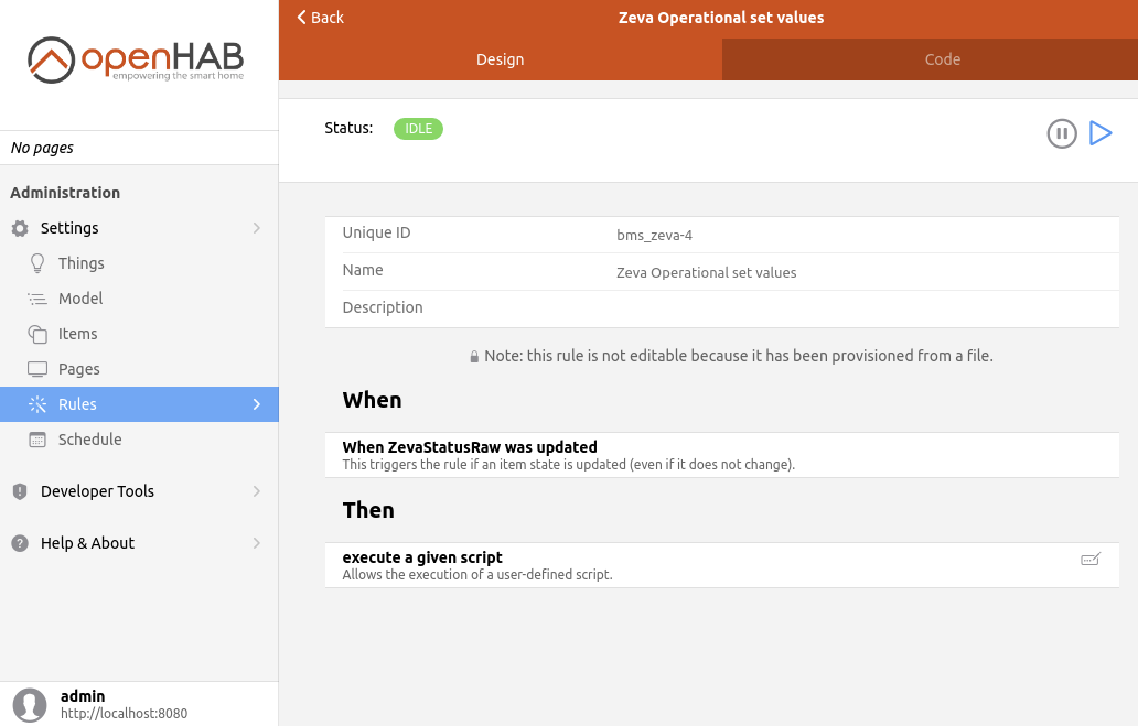

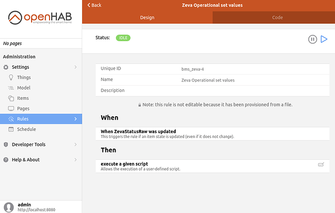

Or adding a rule from file is being ‘sucked’ in, but where does it go, and it cannot be edited, because it was provisioned from file.
Is editing planned in the future?

Text based rules can only be edited from the text file it’s defined in. There is no plan to edit .rules files from the UI. Only rules stored in the JSONDB can be edited through the UI. However, you can enable or disable rules through the UI no matter where they are defined. But I don’t think disabling a rule from a source file will remain disabled when the file is reloaded. I never tired that. NOTE: This is true for Rules DSL, Jython, JavaScript, and Groovy.

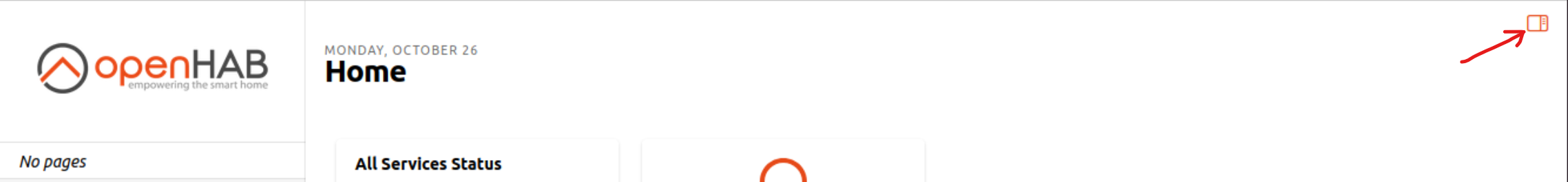

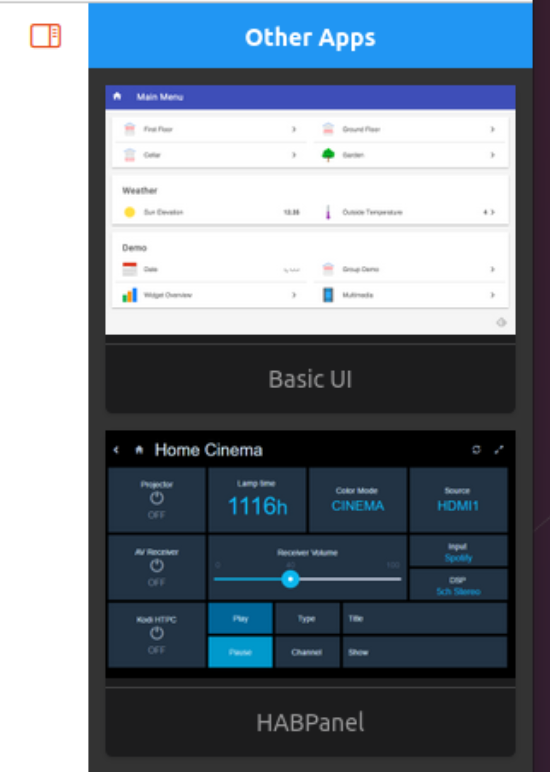

Building a sitemap from the MainUI is in work and not yet completed I believe. To get to BasicUI when you first log in there is a little icon in the upper right corner. Click it and it will let you select one of the other UIs that are installed.
They are an alternative UI and they are really super powerful. I don’t know the future plans for when/if HABPanel or BasicUI will become legacy (not necessarily deprecated but there wont be too much continued development). If you like Sitemaps or HABPanel you don’t need to mess with Pages. But I’ve been playing with them and I find them a little bit easier to customize and build exactly what I want than HABPanel but far far more complex than Sitemaps. Some of the big additions though include:

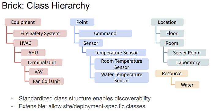

I read up on Brick and then it clicked, as I have used GraphML and ontologies in a work context. The following slide may help to get a high-level appreciation of the model.
(Source: https://brickschema.org/papers/Brick_Memoori_Webinar_Presentation.pdf)
(A more practical view)
… but, the user can decide on how much ‘abstraction’ to use for their home or setup.
[edit] This Google video may help to understand the impact of an ontology…
