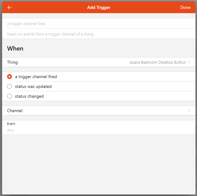

  2. In the OH3 Rules UI it’s created a simple rule, that for now only writes something to the log.
  3. I would like to create a “When” trigger to execute this rule. The OH3 opens a dialog where, between other options, it offers the "Thing Event’ button.
  4. By press on this button another dialog to pick up a Thing is shown. So far so good.

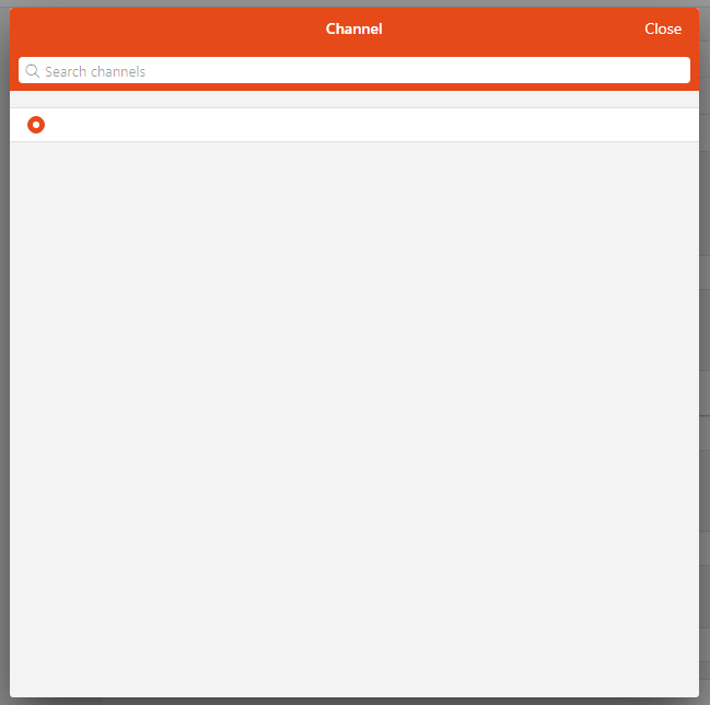

  5. When the Thing is chosen, the new dialog is shown, where I should choose a Channel.But here I have an empty list without any channels. However, as I said before, the chosen Thing has a few Channels, and one of them is the Action channel..

This looks like a bug and an issue should be filed on the openhab-webui repo. How to file an Issue

Sounds like this problem to me
It seems so. It was already reported and repaired in dev. You can try the snapshot of mqtt.generic if you wish to confirm:
 $ openhab-cli console
openhab> bundle:update 236 https://openhab.jfrog.io/artifactory/libs-pullrequest-local/org/openhab/addons/bundles/org.openhab.binding.mqtt.generic/3.1.0-SNAPSHOT/org.openhab.binding.mqtt.generic-3.1.0-SNAPSHOT.jar
 $  sudo systemctl restart openhab.service
I haven’t noticed any significant changes between prod and that snapshot (besides triggers now working) but still consider the risk on your own.
