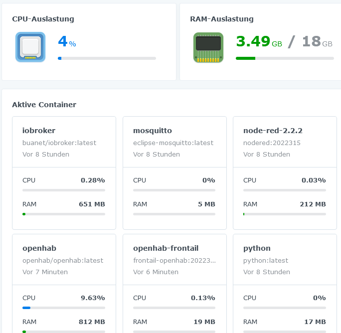

Docker is running in a fairly idle-prone Synology 720. All container only use ab a few percent CPU - openHAB a bit over 10% of its CPU-time…?
should not be a perfomance issue, I think?

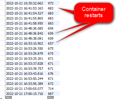

It’s getting weirder…
If I look into what gets persisted, directly after a container restart, there seems to be a “onChange”-persistance, but then after a while it stops and then it’ll just send items to persistence every few minutes or so? This is the consumption item from my inverter => gets updated every few seconds at least.
in TRACE mode there’s no error whatsoever, MariaDB Error-Log is empty

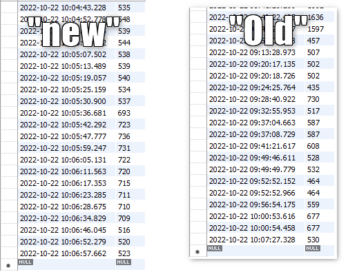

After extensive testing on docker, I just changed the MariaDB-server… and if I chose MariaDB running on the “old” DS214play → everything runs as it should.
If I chose MariaDB on the “new” 720+ → it’s the above mentioned behaviour: persistence every few minutes
So, what’s different between those two?
  • CPU, RAM, HDD: all WAY better on the 720+
  • filesystem: ext4 on DS214play vs BtrFS on 720+
  • 720+ runs docker plus MariaDB
MariaDB recommends BtrFS even over ext4: https://mariadb.com/de/resources/blog/what-is-the-best-linux-filesystem-for-mariadb/
no, this is not true - see next comment:
So, what’s the deal, then? I mean, honestly, there’s no errors in any logs - but persistence is lame vs no error in any logs - and persistence is doing what it should? The only thing, I change is an IP-address and the password in my Docker-OH3 …?
nope, the different MariaDB-Server/NAS was not the issue. I did some more testing and it seems unrelated.
  1. my “old” OH3-container does not want to do any coherent persistence on either MariaDB-instances
  2. my “new” OH3-container does somewhat “better” with persistence, as it persists at a much higher rate, but it also does not persist “onChange”. it persist more - but the intervals could be 30secs or more (as is a MUCH higher rate as the old one), but it doesn’t persist every change - and this is consistent with both MariaDB-instances.
so, I’m back to square 1 again.
