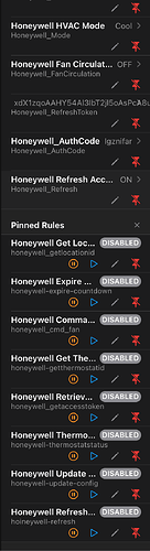

Don’t forget you can tag rules and the search is pretty good. I make heavy use of tags and when I’m working on one thing I’ll just enter the tag for that one thing into search and only see the relevant rules.
You can also use the developer sidebar and pin the rules you are working on instead of only going through the rules page. For example, if I were working on my Honeywell API stuff my developer sidebar would look something like
Notice how not only can I jump to the pinned rules to edit them, I can also pause them or run them manually right from the sidebar.
I find these two features make it so that the number of Rules just doesn’t matter. I can pin what I’m working on the one time and never have to look at the rest while I’m working.
