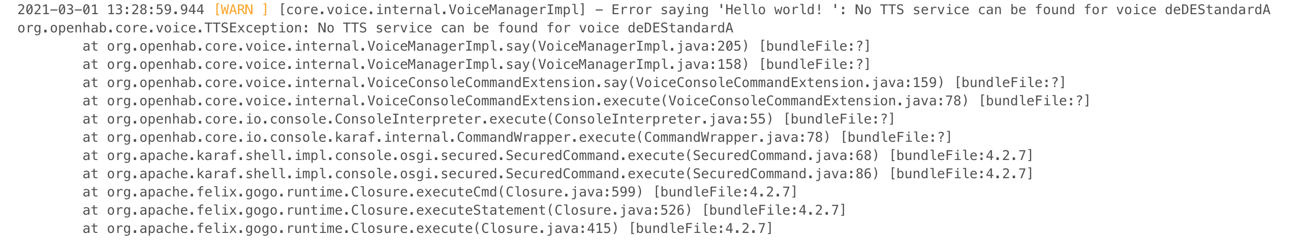

then I am issueing a say-command like so
say(“Hi”,“googletts:deDEStandardA”,“chromecast:chromecast:686668768768767ed035d702f3fd4a6”, new PercentType(50))
and I get
2021-03-01 10:34:09.767 [WARN ] [core.voice.internal.VoiceManagerImpl] - Error saying 'Hi': No TTS service can be found for voice googletts:deDEStandardA
org.openhab.core.voice.TTSException: No TTS service can be found for voice googletts:deDEStandardA

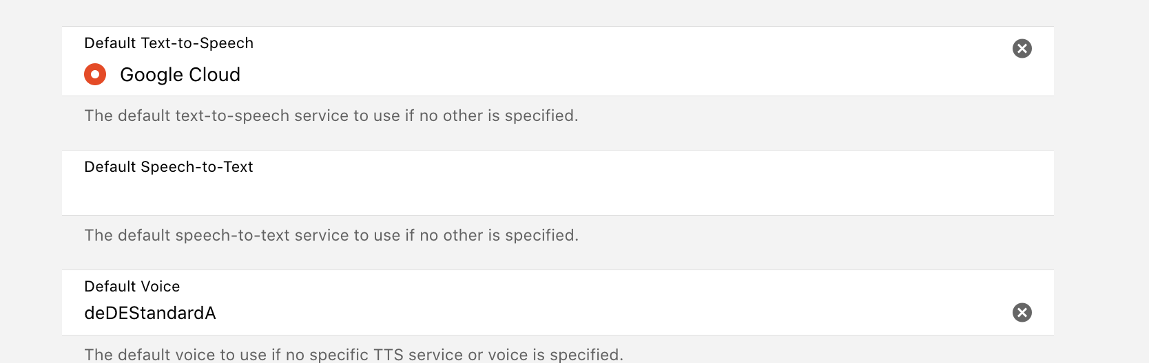

There is no way to select a “standard” voice in the UI or do you refer to a different setting?

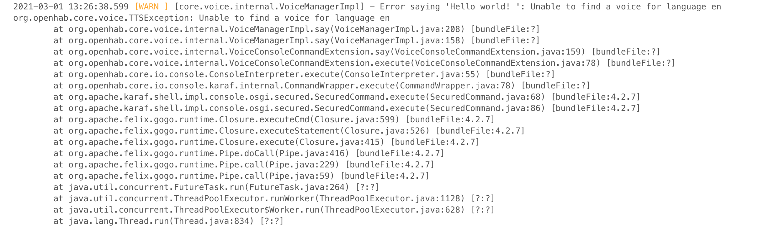

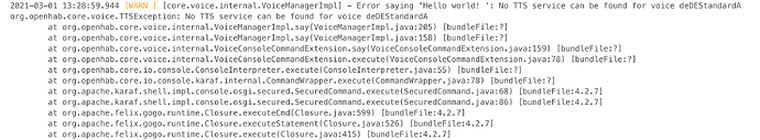

I removed the setting and issued the command in the console
openhab:voice say Hello world!
and when I re-add the voice to it
and
I get

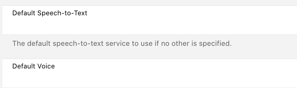

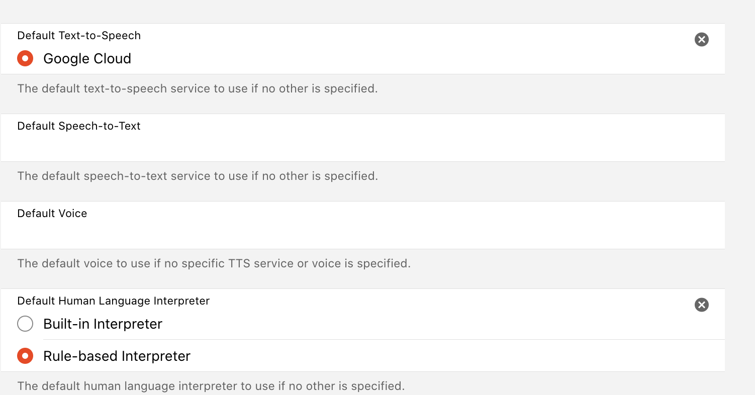

The “Default Voice” field should be a selection list of all voices that can be selected for your tts service (Google). Can you confirm you get a list of voices when you click on it?
Did you use “Desktop” as application as described earlier in this thread?
It looks like your authentication goes through, but it is not able to connect to the Google tts service
No, none of these are dropdowns (like it was the case in OH2 - note that I am already on 3.1). Both are text boxes.
And yes, my client is Desktop (and I also tried “TV” like explained in the actual documentation).

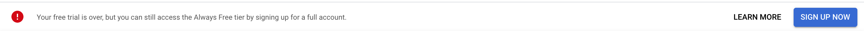

Hi Stefan,
I ran into the same issue yesterday:
After some digging and following the different links in the binding documentation, I have noticed a message on the top of one of the pages saying that my trial or demo period was over (I don’t remember the exact wording). After I confirmed that I want to proceed with a “full account” it started to work again after I had created a new Authorization Code for the binding.
Hope this helps.
Matt
OMG, it was always there at the very top and I happily ignored all the time :man_facepalming:
Matt, you saved my day! :man_superhero:
  • Press “Sign up now” and click through two pretty unimpressive dialogs and you are set!
