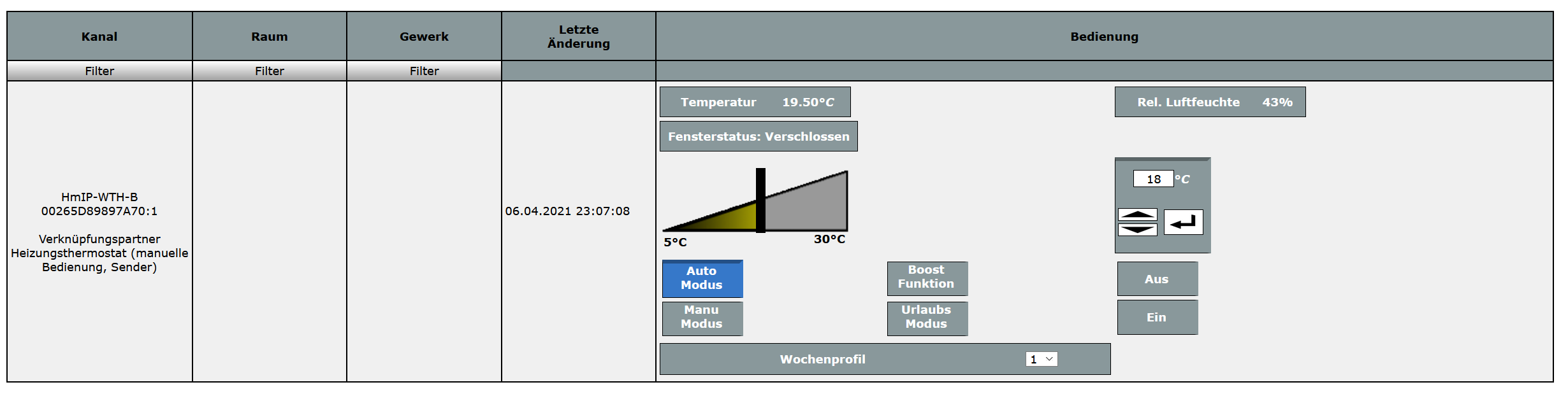

I have the same problem with my Homematic Thermostat.
I can still control the Temperatur etc. in OH3.
When I change the Temperatur in CCU3 the value in OH3 is updated too as it should be.(update. seems not to work anymore)
However the actual Temperatur is not updated.
I have to stop/start the Bridge Thing in OH3 to get the value refreshed.
Any clue?

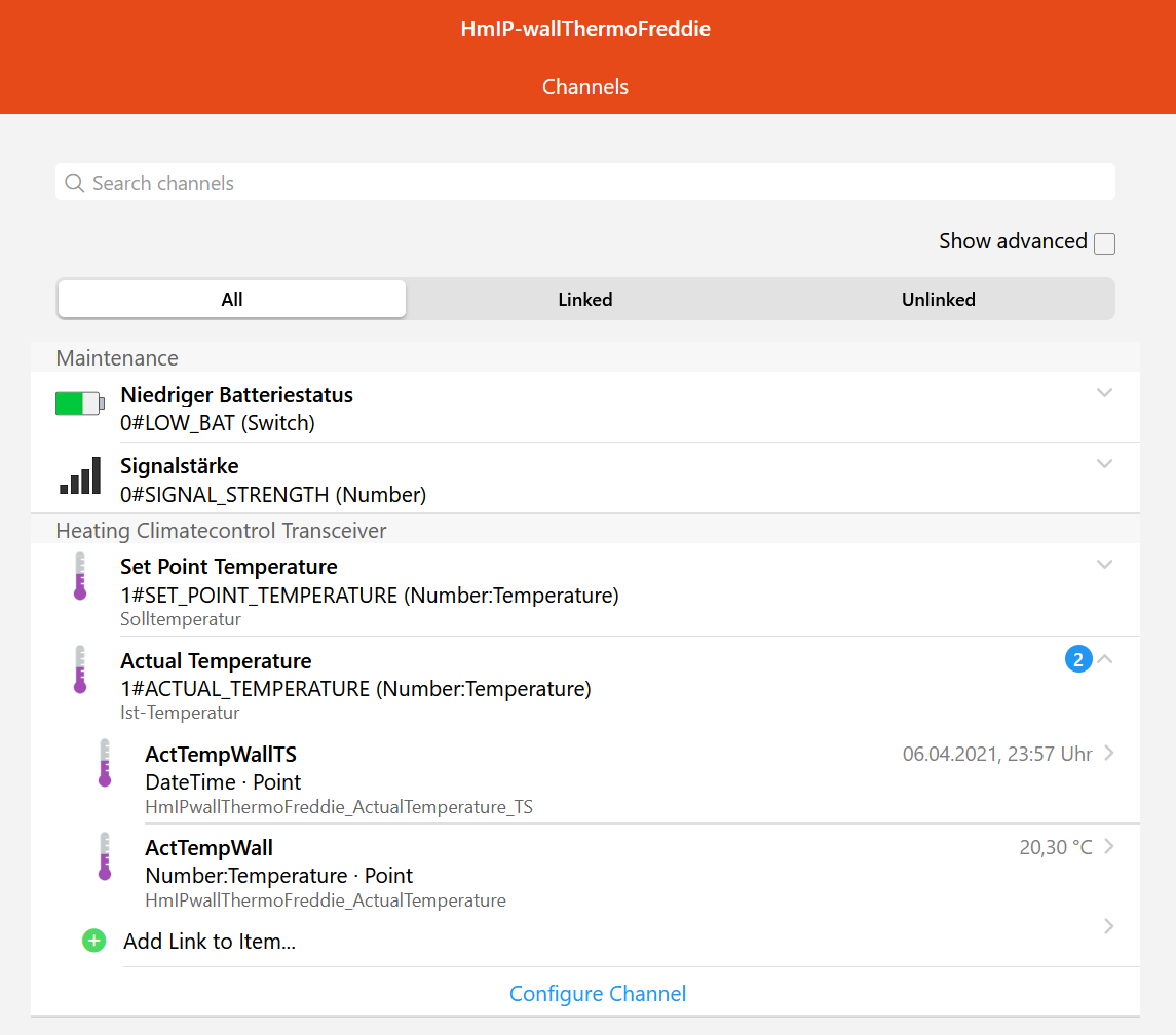

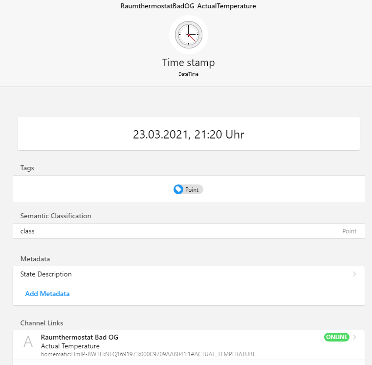

I’m wondering how to track when an item is not refreshed for a long time?
Unfortunately I didn’t find a timestamp in the available channels.
Any clue how to monitor this?

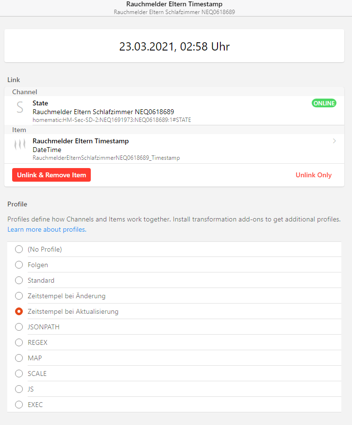

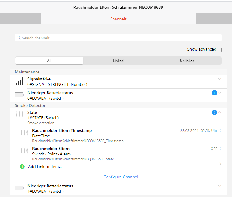

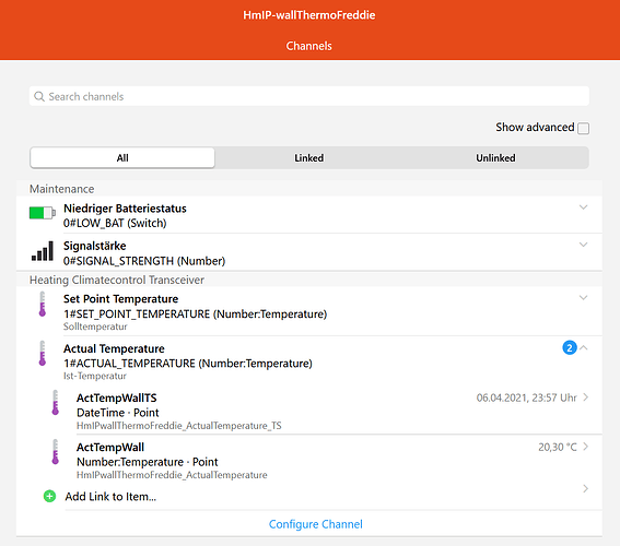

you can add a timestamp to any channel. This is a nice feature. i am monitoring all of my battery driven devices if they are still alive. Just add the appropriate profile to the item.
Thanks again Jan.
Homematic things are updated properly since I use the updated SNAPSHOT binding. :smiley:

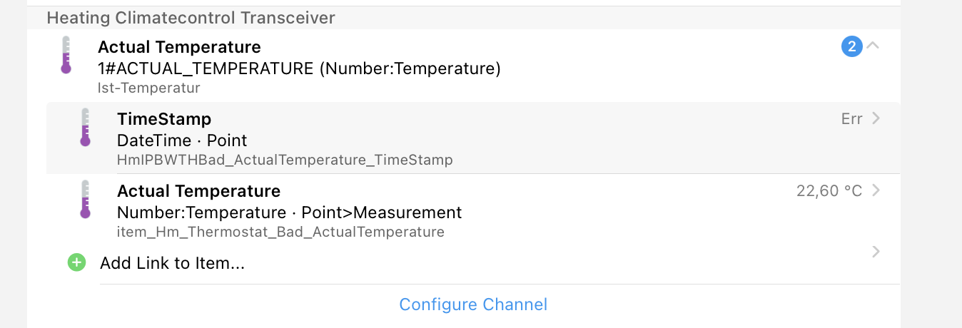

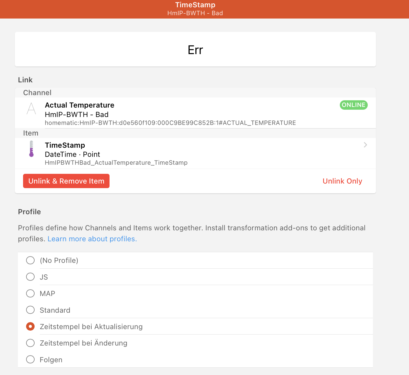

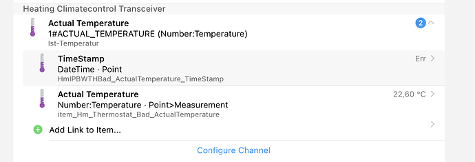

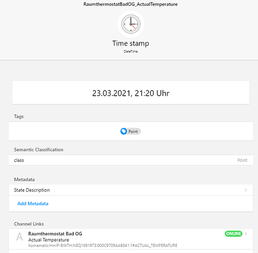

I also tried to add the Timestamp as you described, but I get an Error :frowning:
add metadata to the state description of the time/date item in pattern:
%1$td.%1$tm.%1$tY, %1$tH:%1$tM Uhr
This should then work.
thanks Jan, that solved the problem :slight_smile:
