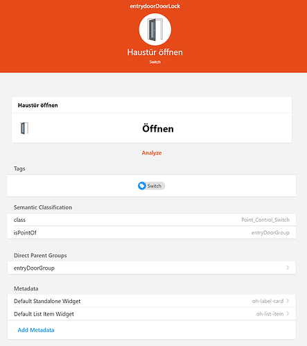

Hi @Boby,
you have to define the default standalone and list widget in the metadata section of the item.
There you have some options to define Actions behind labels.

Oh of course, this works with e.g. a label card widget and the action type “command options”!

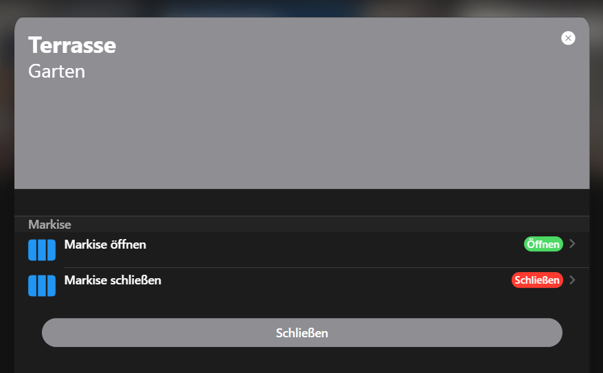

As a beginner i had some trouble to implement the item. So here is the code for the list item i use to control my sunblind. I don’t need the label card because the sunblind is part of an equipment in my model.
Hope it helps if there is someone in the same situation as i was ![]()
value: oh-list-item
badgeColor: green
actionCommand: ON
badge: Öffnen
actionCommandAlt: ON
actionItem: sunblind_opening
icon: f7:rectangle_split_3x1_fill
iconColor: blue
action: toggle
Here is how it looks like
