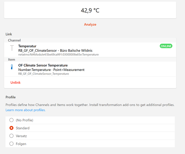

So startet to check the profile fuctionality, but get it to work. I startet with the offset profile.
I opend from the model a temperature item.
then i clicked on the channel links

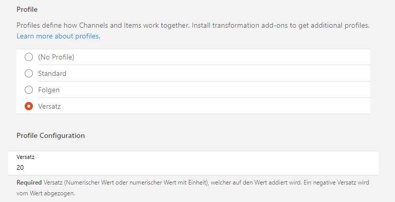

Then i select “versatz” (Offset), enterd 20 and saved
From my understanding a value of 20 is added to the value comming from the sensor, but nothing happens
So what i am doing wrong?
Hmm, sure you don’t need to tell it 20 what you’d like to add to a Quantity type, e.g degrees C or F etc.
Mind you, I’m only guessing it is a number:temperature type channel, the UI is hiding that.

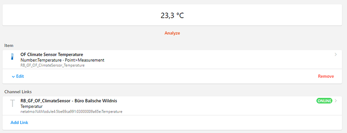

Tried it with 20°C → Nothing happens. With “20 °C” it works,

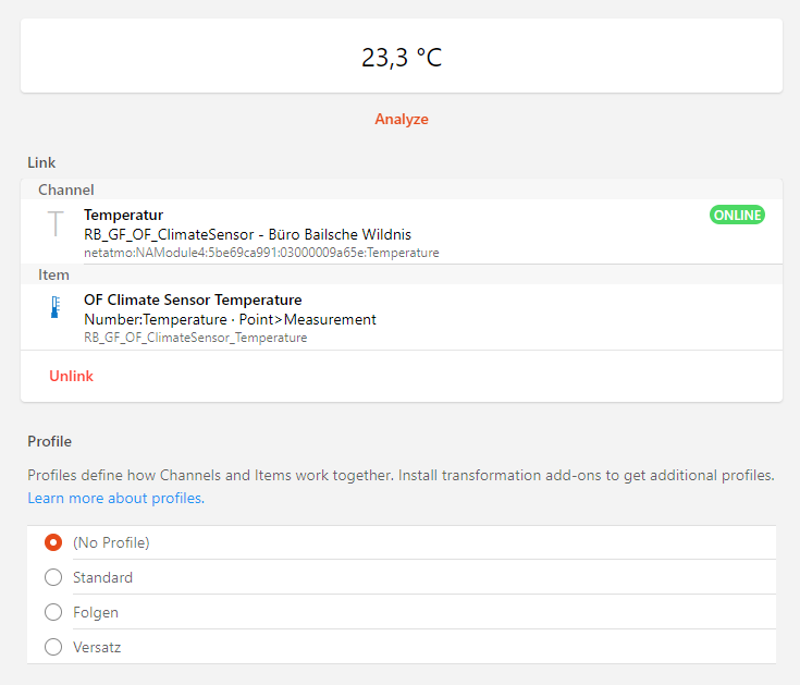

but now i do not get rid of the offset. If i change the profile to “No Profile” and click on save the profile is not deleted.

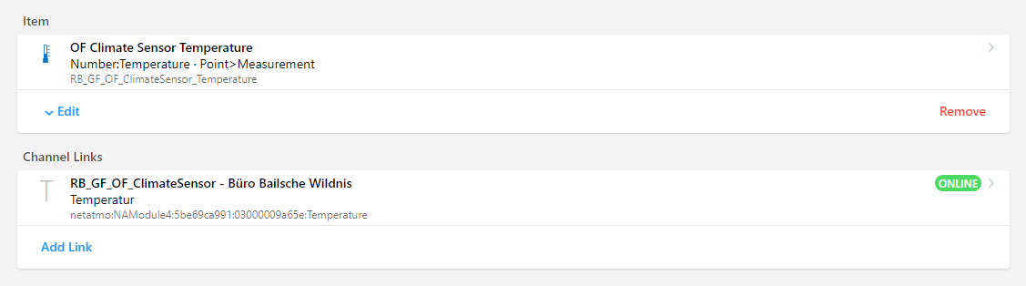

It is even worse. If i select standard the offset profile is still used
Nothing. :frowning_face: See:
https://github.com/openhab/openhab-core/issues/1645
So the the offest profile works in general. Unfortunately i get still some log messages.
