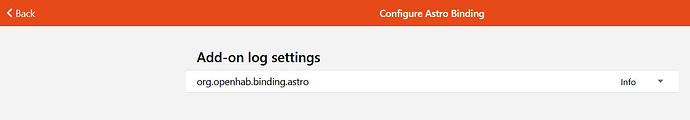

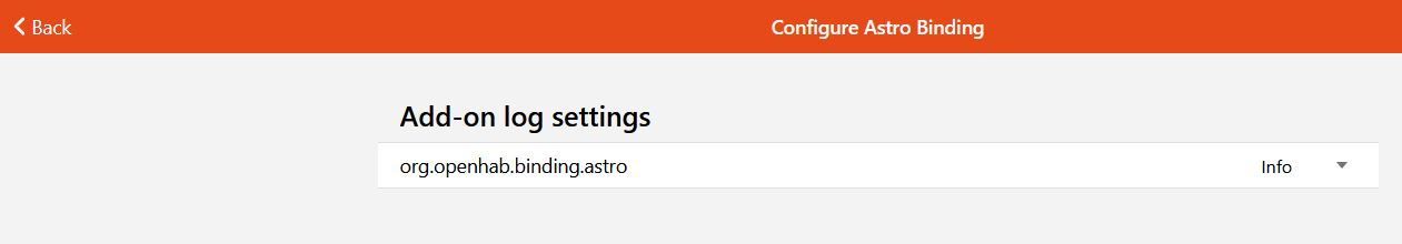

There are some PRs that I think are not yet merged that will let you set the logging level of openhab core as well as bindings through MainUI. Until that happens, you’ll have to use the Exec binding or executeCommandLine to issue the command.
