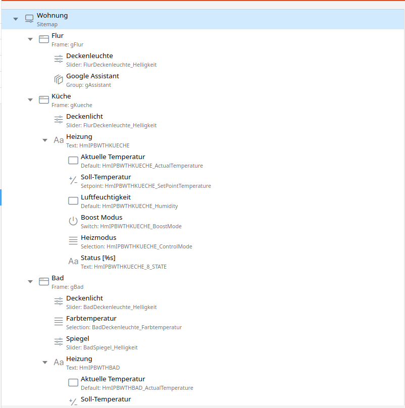

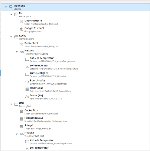

It happens to me now the third time that after several hours of work the sitemap in OH3 is suddenly incorrect and I can not understand at all why this is so.
Sitemap looks like:
Here the complete sitemap

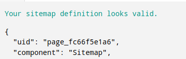

Unfortunately, this sitemap definition leads to errors in the log:
2:38:16.517 [ERROR] [components.UIComponentSitemapProvider] - Cannot build sitemap page_fc66f5e1a6

This sitemap was created 100% through the GUI, I did not edit anything manually.
Even more incomprehensible: The GUI itself claims that the sitemap is OK:
What I understand even less: If I copy exactly this sitemap 1:1 into a text file and copy it to
/etc/openhab/sitemaps/wohnung2.sitemap
this sitemap works without errors.
And: this sitemap worked fine via the GUI for several hours during creation, until I added the last two elements. These were:
Switch icon="light" label="Lichtsäule 1" item=Lichtsaule1_Schalter
Switch icon="light" label="Lichtsäule 2" item=Lichtsaule2_Schalter
But even if I remove them again, the sitemap does not work anymore.
When this happened to me once, I started completely from scratch. But now I don’t like anymore…
Maybe someone has an idea what happens here?
