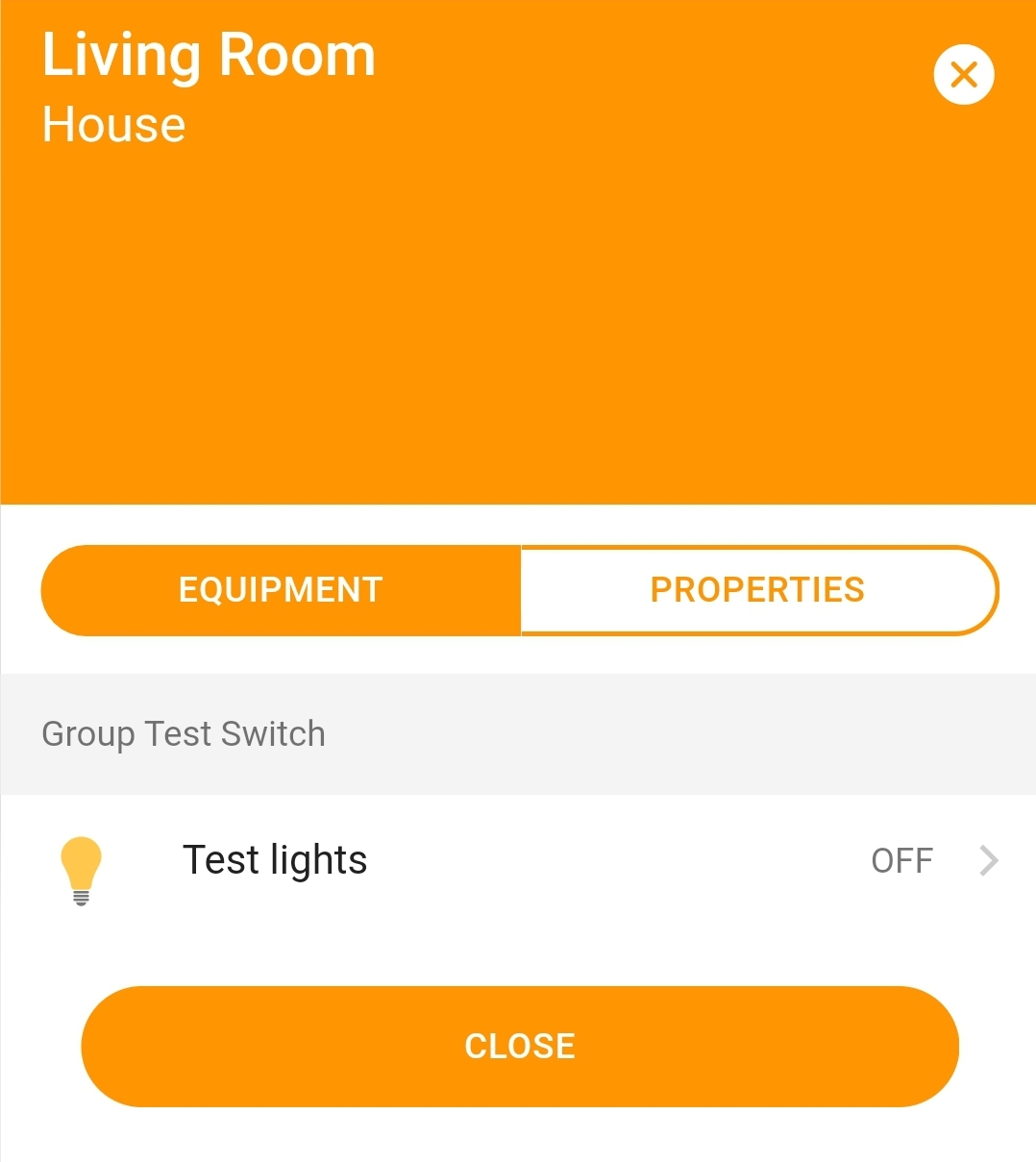

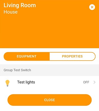

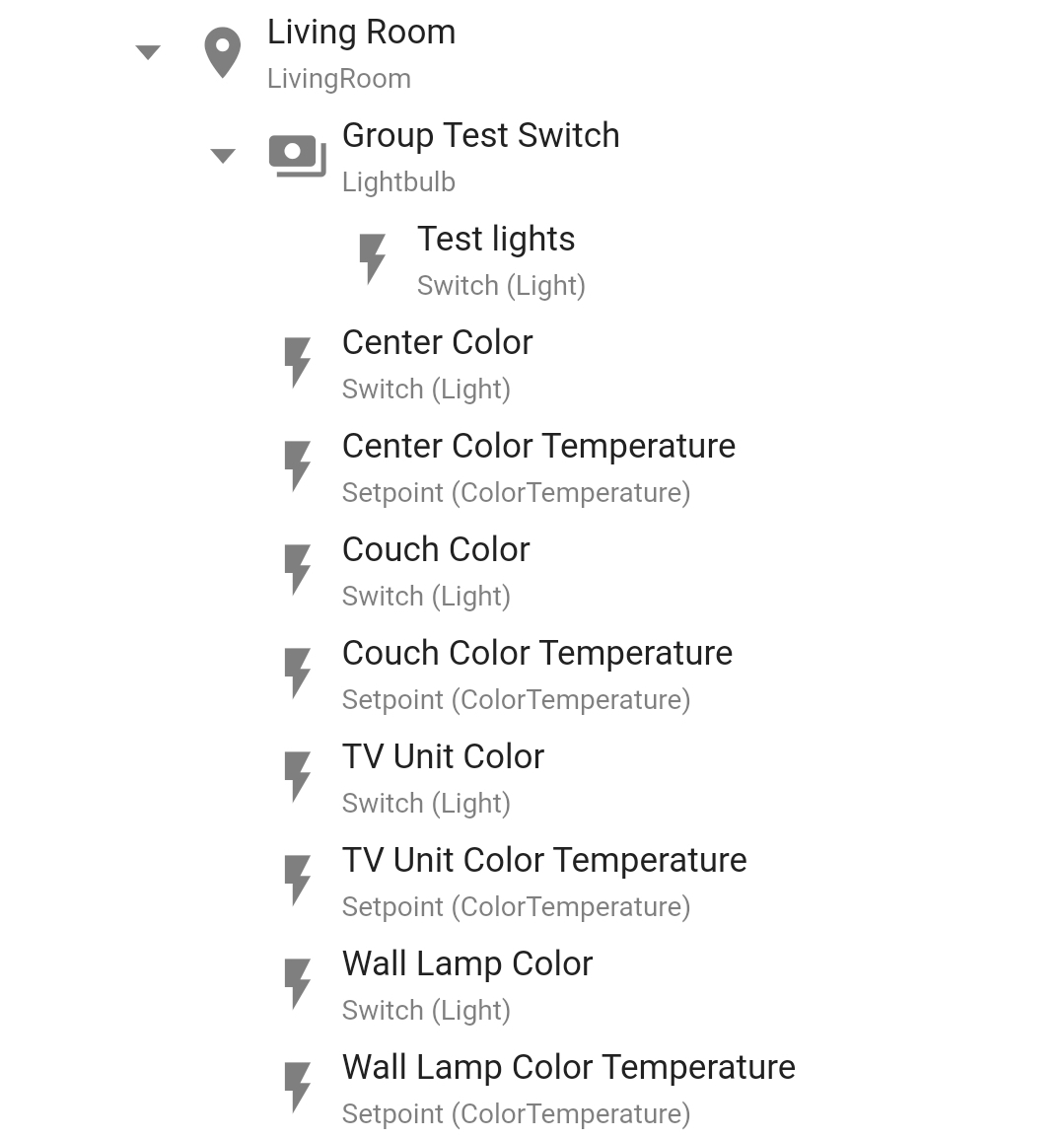

I have created a group and assign the individual light switch items. This results in the Location card displaying the group name as the header and then each individual light things switches listed below it. See below:
Is there a way to make this a single master switch instead of displaying individual switches for each light? Similar to the image I have mocked up below:

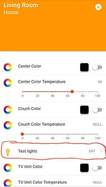

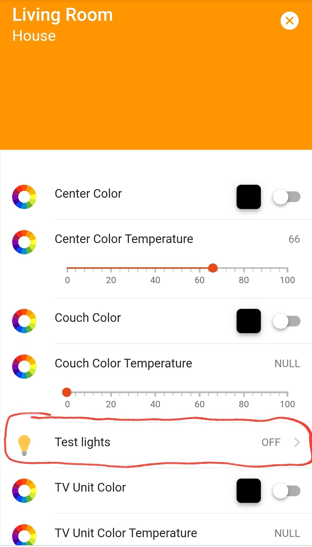

Create the Group:Switch and tag it as a Point, not an equipment. For example, Switch,Light.
Add the light switches as members. Because it’s not tagged as an Equipment it should be blind to the fact that it’s a Group and not show the members under it.
Add the Group as a member of the Location Group.
However, there is a gotcha. Because it’s tagged as a Point and not an Equipment, that Group:Switch is going to appear under Properties, not under Equipment.
If you want it to appear as an Equipment, you’ll need to define the Item as a Switch Item and write a Rule to forward the commands to the Lights (i.e. a Proxy Item). Or do like you’ve done and link all the Channels.
Also don’t forget that first tab on the Overview Page. You can put what ever you want on that tab. Maybe it makes sense to put those common controls there.
Hi Rick thanks from your response, that works. I created a group switch as a point instead of equipment and this now displays the single item for the group as seen below:
This displays the group showing the status instead of a toggle switch though. Using your suggestion of creating a proxy switch with a rule to forward the commands resolves this.
Alternatively to get it to display under the equipment I can create an addition Group Equipment Lightbulb under the location then add the group switch as a direct group member, the downside is this does not display as a switch though.

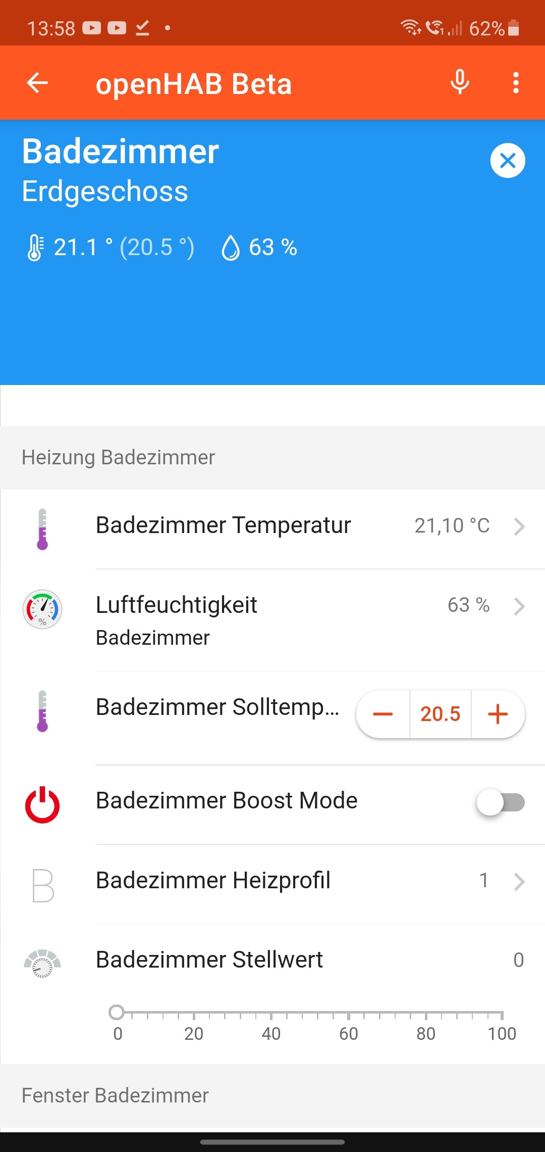

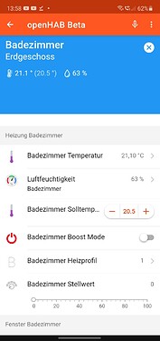

Hey, a little bit off topic, but can someone explain me how i get the Tabs “Equipment” and “Property” in the Location Cards? I dont find any Information about it. On some pictures there are the Tabs and in some other pictures there are no tabs
In my Setup (Equipment and Propertys are added to the location) there are only Equipment listet and there is no Property Tab. And i find no setting to enable it.
