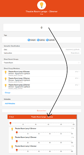

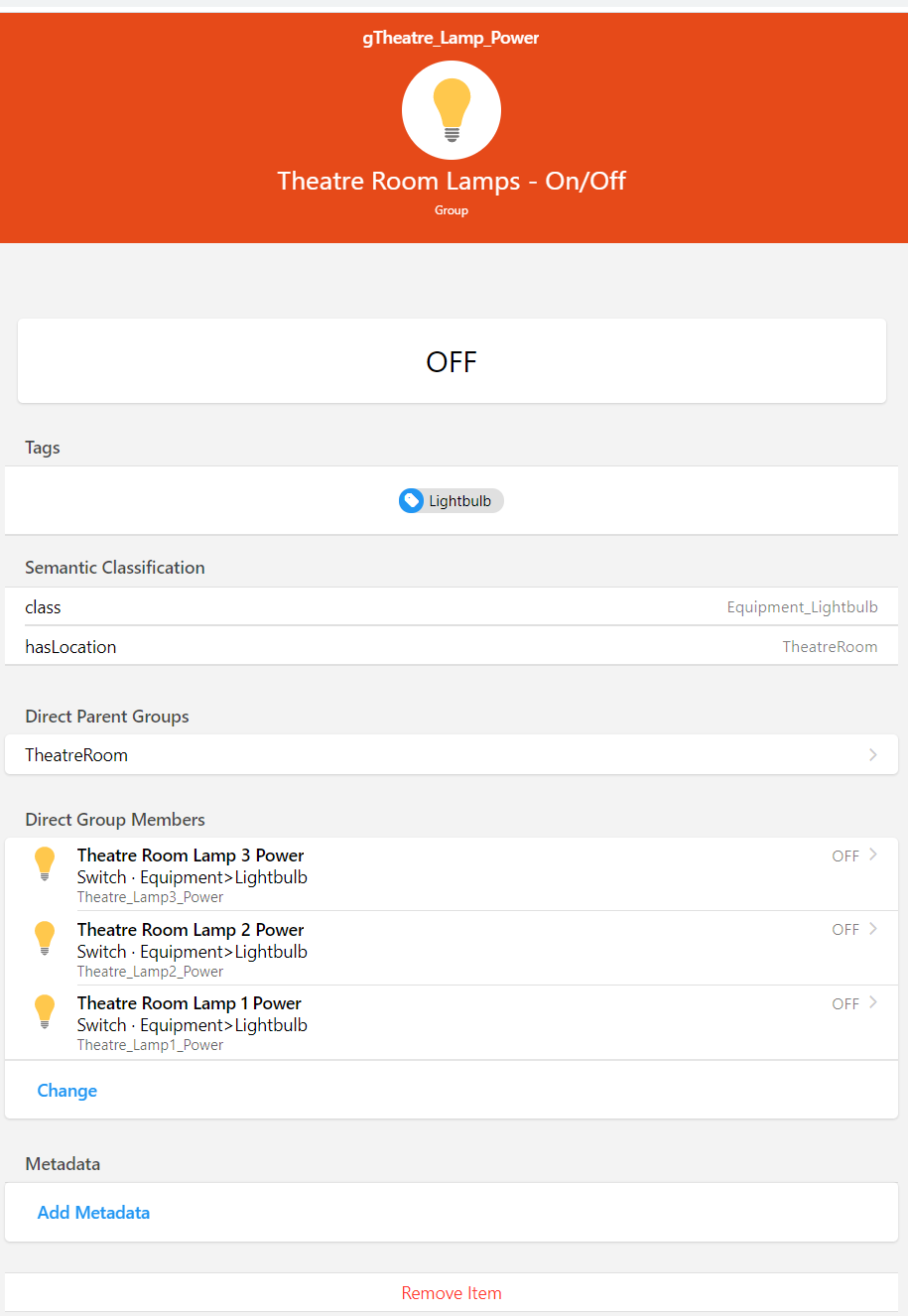

Yeah - worked it out as per the pic. You can group multiple similar “things’s channels” as one “item” that then gives you one control for all (or even individual control). I don’t think you can’t group an entire “thing” (with multiple channels) to one Item.
FYI - When I group an entire “Thing” with multiple “Channels”, the resultant “Item” does not present you one set of controls for the entire group, just the option to individually select each “Thing” from which you can operate the channels.

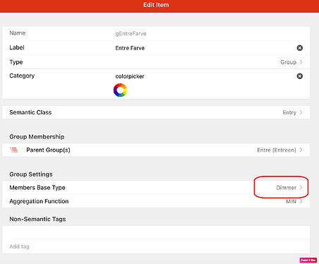

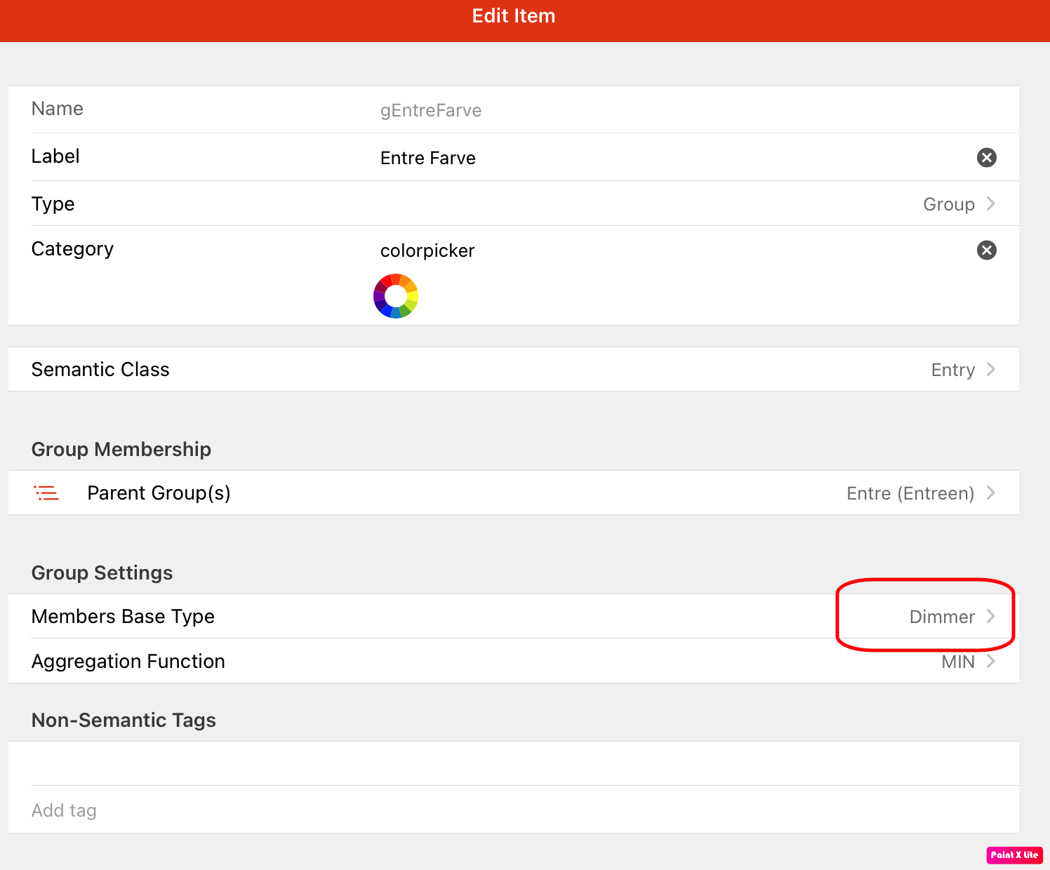

The solution suggested by jmone in post #7 works very well also for dimming hue color bulbs - you just need to set Members Base Type as Dimmer like this:
Does anyone know how to make the group work as a color item that can be used to control the whole group with one color picker card?

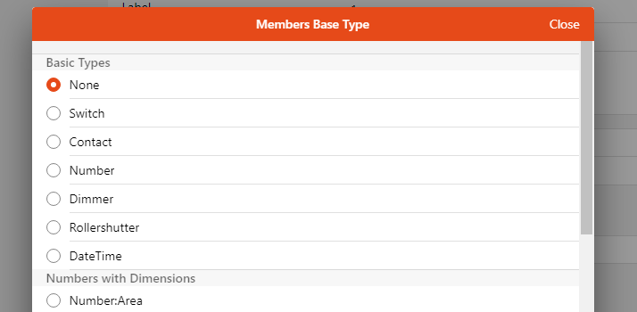

Having played around with the various options in the Members Base Type, e.g. Switch, Contact, Number, Dimmer, Rollershutter and DateTime, I think that actually a Color option would need to be added to the Members Base Type in order for a color picker card to be able to recognize the group.
Any thoughts on this? Or any suggestions for a workaround - could obviously just be done with a rule but it would be much more convenient to be able to control color lights directly through a group.

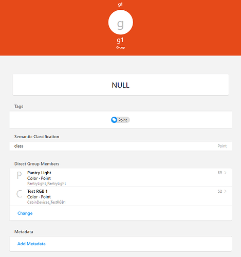

As you noted, the Group:Color doesn’t exist (basically color is not a type for a group). As such the Group doesn’t know how to deal with all the different color values that may be set on individual items and hence may contain a ‘null’ value which was not handled by the colorpicker control.

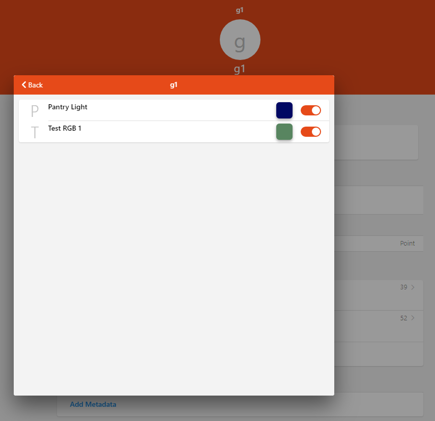

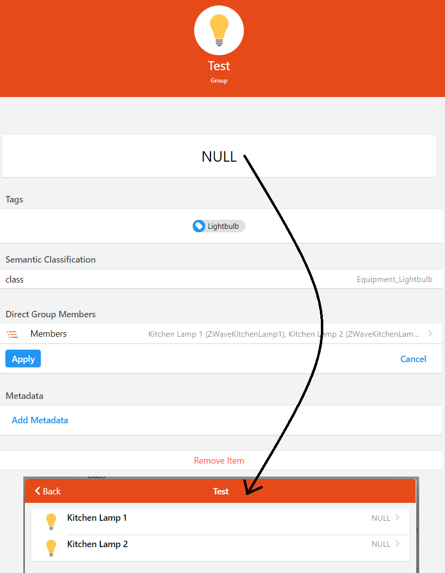

What do you want to happen? By default, the Group with no type will list its members, that’s its default widget.
You’ll want to change the widget in the Group Item metadata to get something else - not sure if you need to assign the Group a type, I think you only need that if you want a group state (which you might very well need for a colorpicker style widget).

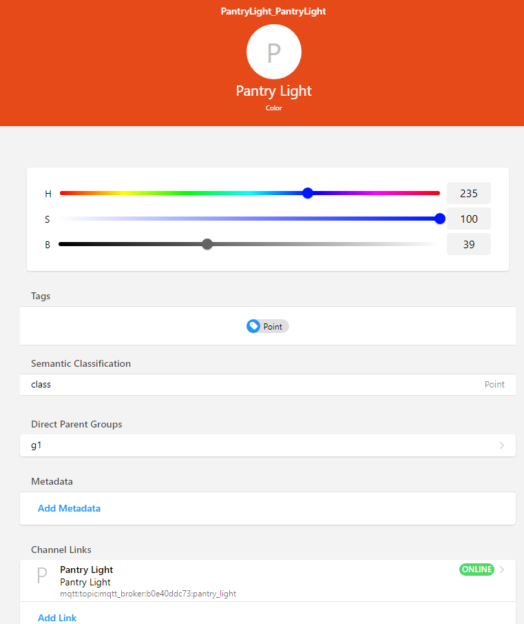

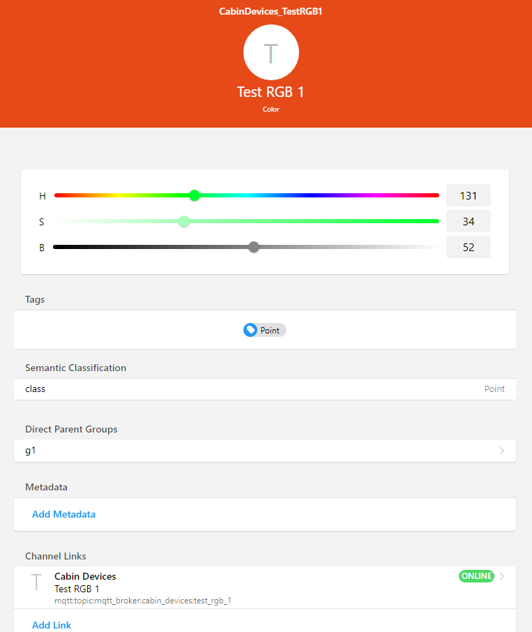

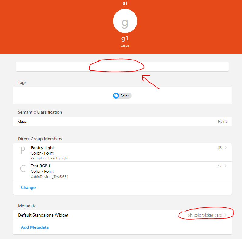

I’ve 3 HSB lights that work fine alone, I want a group control so I can control all 3 together, as that will be normal use. Only once in a while might i wish to access each alone.
I’m not really clear what to do here?

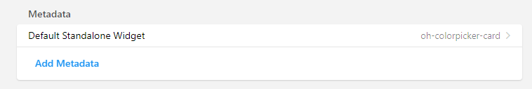

I pick on metadata on my group item and I get a list of namespaces (which colorpicker is not in)
So I type one? where to a find the color picker one?
I googled here;
So entered oh-colorpicker-item but my guess did nothing!
I’m not too sure I know that going on in this part of config, not used it yet.
Entered it where? I think you want “default Standalone Widget”.
It may be the UI doesn’t offer it to you because your Group has no sub-type. In the Item properties, this is rather misleadingly called “members type” but really it sets the Group (sub) type.
This is a UI problem, they accidentally omitted the Color type for Group selection. I thought this was fixed some time ago, but maybe not.
There are workarounds, you could define the Group using the old xxx.items file text syntax, and paste that into “Add Items from Textual Definition” to create the Group:Color type.
On reflection though, I don’t think that’s going to help in the long run. To be much use, the colorpicker UI widget wants a starting point, a valid state from the Group.
That’s okay, Groups have “aggregation functions” like MAX or AVG which will give the Group a state based on members states.
BUT
I don’t think that’s properly implemented for Group:Color

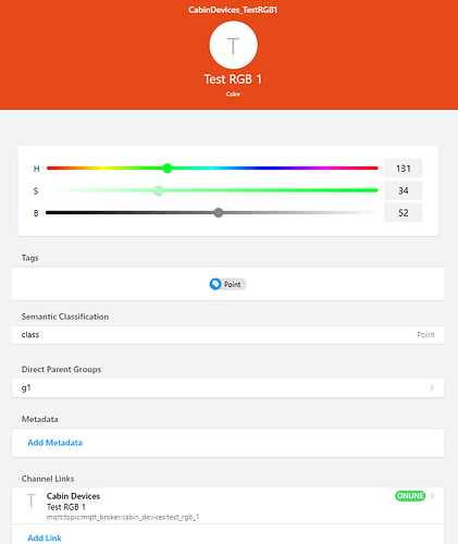

I don’t know what kind of lights you are dealing with here, but an alternative and very kludgy approach to using a Group is to create a new fourth “ordinary” Color type Item, and link it to all three of your binding channels (as well as keeping their original independent Items). This is @joriskofman suggestion above.
The state of this Item will be a bit indeterminate, but it should be usable with a UI colorpicker to transmit common commands to the three channels.
